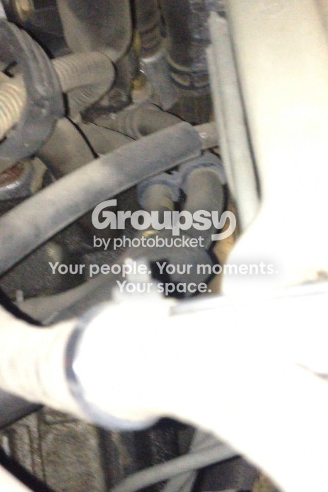

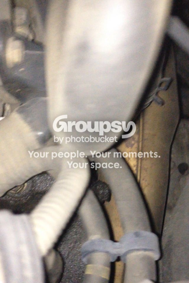

These are terrible pics but they're from a video I took, back of engine near firewall. Btw no recent services done to vehicle that would still be burning off-
image_zps34bff688.jpg~original
image_zps45d5961d.jpg~original

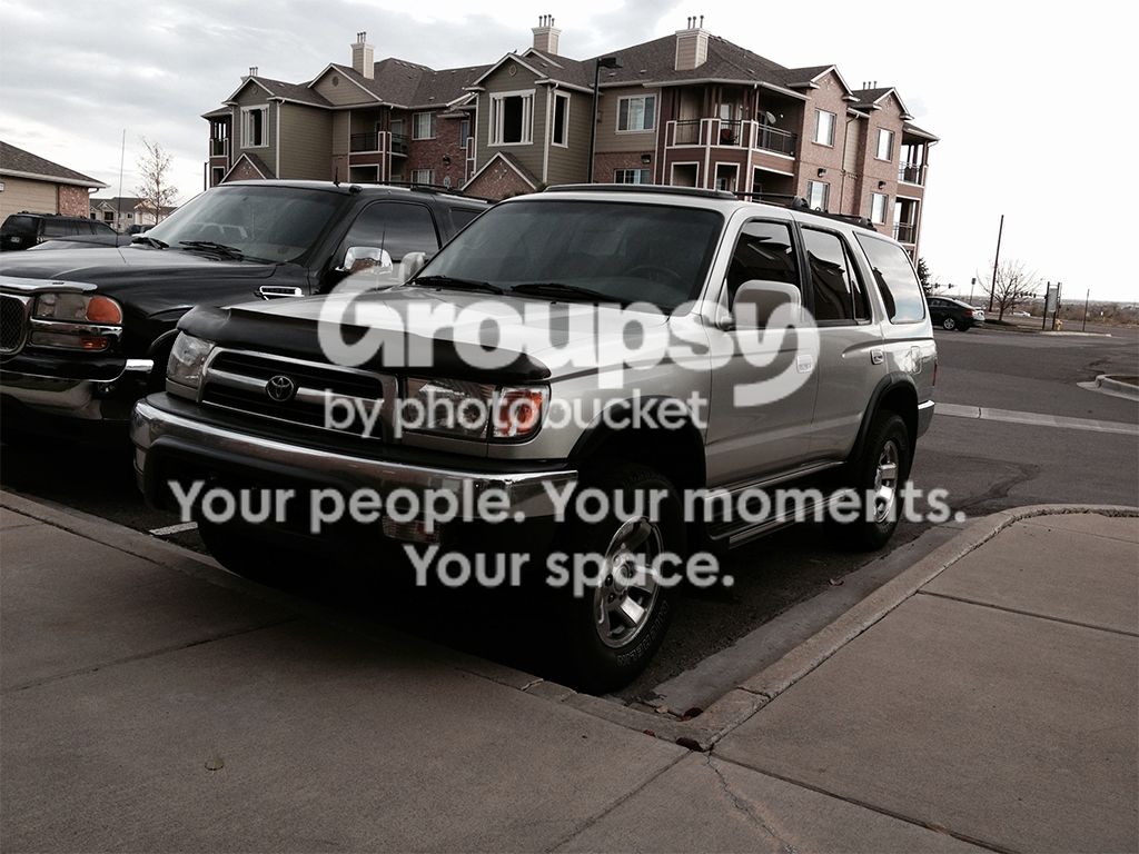

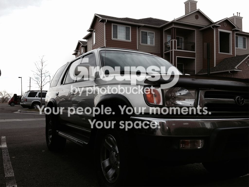

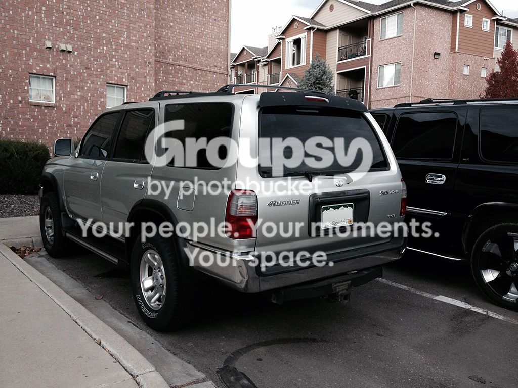

rundrivside_zpsfd4878d1.jpg~original
runpass_zps1b08600b.jpg~original
runrear_zpsc1fbf605.jpg~original
rundswhole_zps53685a91.jpg~original

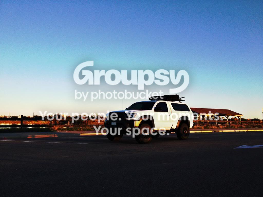

This is my other vehicle by the way, may have seen it around up there. Once I put some miles on the 4runner and make sure it's reliable enough, I'll start swapping whatever I can from truck to 4runner, return it to stock, and get rid of it (probably replace it with a new Subaru). Nothing fun about a 4cyl truck at 5200ft. Reg cab isn't much fun now either with a girlfriend and hopes of having kids some day.
tside1_zps72eb41c3.jpg~original
slv4.jpg~original
