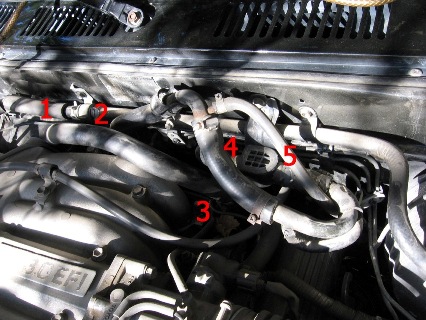

I think I've found the problem. The heating system seems to have been disconnected from the engine. Take a look at the picture. The 1 and the 3 is the hose that is (I think) the Out and the In for the heating system. Then the 2 and the 4 (and 5) is the heating hoses that seem to be looped withing the heating system.
Could you guys take a look at your heating hoses and let me know how they are supposed to be connected.
I don't know what the previous owner did. I know that initially the vehicle was equipped with AC (I still have the AC button) but it was removed (and sold I guess..).
Thanks a lot!

Sorry pal, you will need a 2nd gen owner to look at their system and compare to your picture. I have a 2005 so I can't help you. Buzz around this forum, then try yotatech.com.
No problem, thanks for your hints. I'll look around, but technically, the heating system can't work if it's not connected to the engine?...
I think what I need to figure out is where is the intake in the engine and intake in the heating system...
Thanks again..
There should be a valve that the control cable from the dash for heat-cold goes. Suspect it was where the big hose is now. I'll see if there is a photo or diagram in the Chiltons or Yota shop manual I have. If so I'll scan it in and send it to you.
Thanks, any diagrams will definitelly help.
