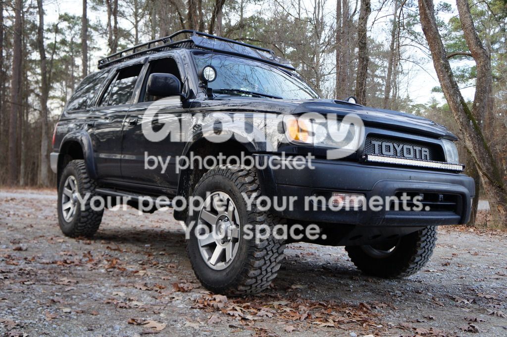

Here's my truck with the coilovers and LC coils. I'm at 22" upfront and 23.5" in the back right now. 150lbs of skid plates underneath, 100 lbs of sliders, and 100lbs of roof rack on the roof is all the additional weight I have as of right now.
