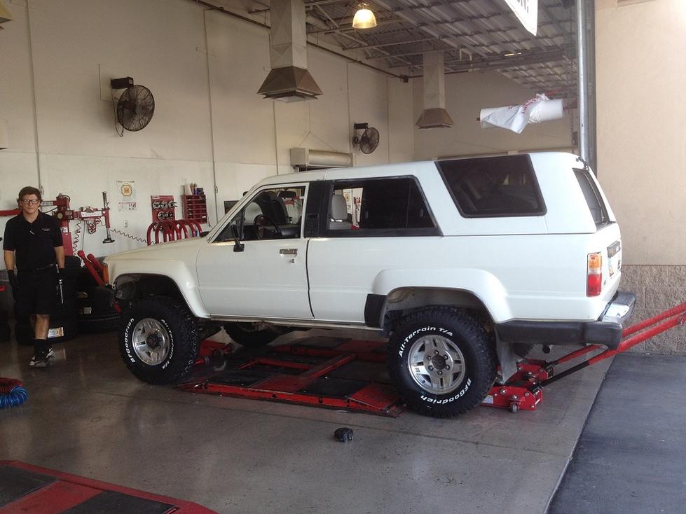

OK OK OK. After much debating I finally broke down and spent the xtra $ on the 31's and I am glad I did! Thanks to all for your input!
