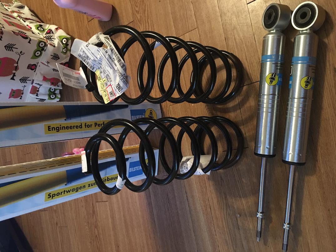

So, I noticed my driver side sagging a month or so ago.
Figured I'd go ahead and lift her while I replaced the suspension.
I'm going with stock coils up front on Tundra 5100s.
In rear I'm going with 99 talls, Bilstein 5100s, and a Daystar 1.5" spacer.
Should get about 2.5 inches out of her.
What hasn't arrived yet is the Daystar and the rear 5100s. I'm in south Louisiana and in case you didn't know we are all under water so shipping has been an issue. Also, it will be a while before I can install. I've a little water in my house and have been going to Baton Rouge to help friends gut their homes.

Agreed. To level my truck with new OME coils up front and new LC coils out back I needed the OME 10mm and toytec 1/4" spacer.
