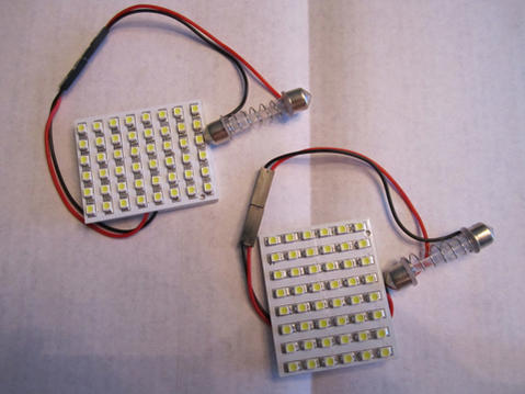

[MENTION=69868]LittleCaesar[/MENTION] for what it's worth I installed these 48smd led panels in my dome and trunk light 4 years ago (wow time flies!) and love them. Super bright, no more shadows. A two-pack on ebay was $1 and they came with assorted adapters for various bulb sizes. Just plug in the De3175 festoon and stick the panel in using the adhesive back. The exact ones I got are long gone but a search for "dome led panel" should do it.
