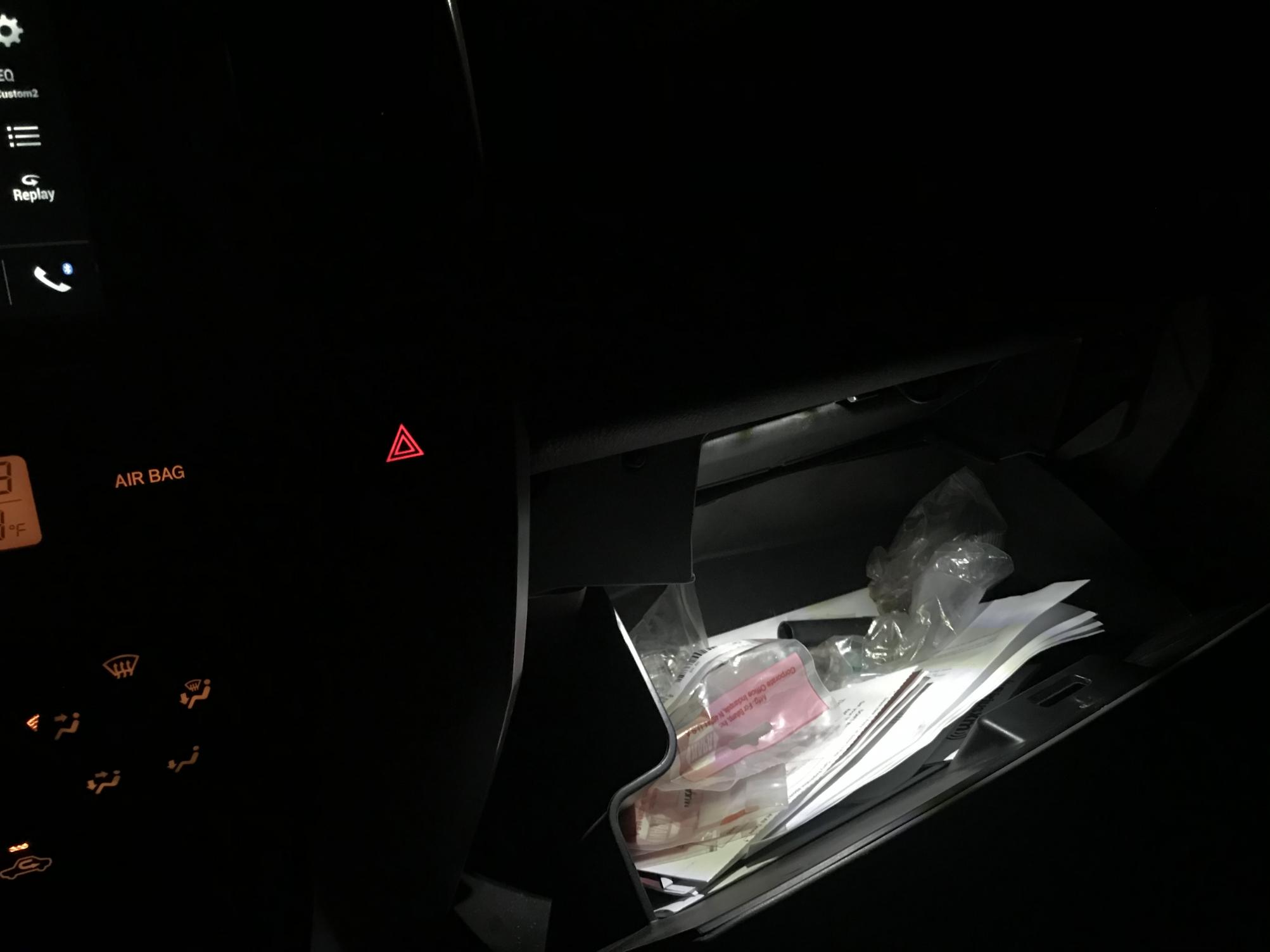

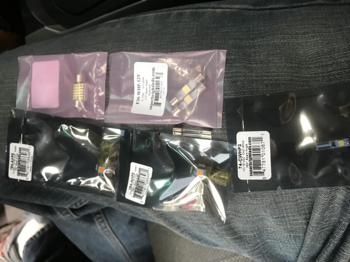

For the glove box it’s a 74 led size. Here’s a link for the one I got. It’s nice and bright.
74 LED Bulb - 3 SMD LED - Miniature Wedge Base | Super Bright LEDs

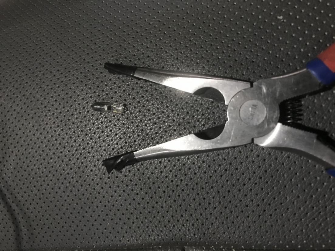

It was a bear to get out, I had trouble trying to open the little access hatch (if you will) so I just went through the grille. Wrapped electrical tape around my needle nose to get it out and put in the new one.
It’s a ton brighter than the factory one. Factory is actually so dim I didn’t even know there was a light there. It’s brighter than it looks in the picture here.

Thanks for the link! I ordered an LED bulb so hopefully it shows up soon and I can try it out.
If the improvement is the same as it was with the remainder of the cabin LED lights I installed, then it will have been worth the money.

My LED bulb for my glove box just showed up so I'm going to put it in tomorrow. Looking forward to seeing how it looks. Redoing the rest of the cabin with LED lights gave me good results.
Got the bulb installed and it's a big improvement although I have to say getting the glove box in and out was...interesting.
