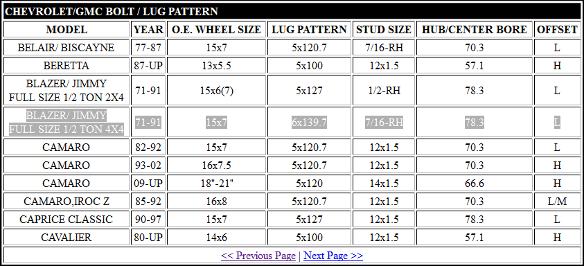

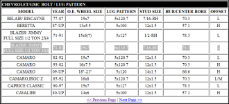

so you had to buy an adapter, because they didnt bolt up is what you are saying? basically your trying to say im wrong, but you admitted that you had to modify the mounting system to accommodate the wheels...
not to mention that those are 15" wheels and they probably wont clear your calipers or tie rod ends because of the different offset as well

I use to run aftermarket wheels that were designed for a chevy but like stated above the center bore is too small so I got spacers. Lug centric spacers to be exact. Worse idea! Horrible bump steer and wobbling. If you can find toyota to chevy hub centric spacers/adapters than that might be an option for you. Personally, I don't think all the trouble is worth it, just find some Toyota wheels.

wont work, the hub diameter is too small
I can machine the wheels I.D. to the required diameter.

ahh you are correct, im used to those wheels in the 5 lug for the s10 and blazer, but still hub bore is way too small, and i dont think you can machine it, but i have never tried... but i think machining out that much of the wheel would take a lot structurally away from the wheel im not sure what the offset is, but im pretty sure the 4runner wheels push out further than the chevys, as the chevy axles are much wider in comparison (yes i know their trucks are wider as well)

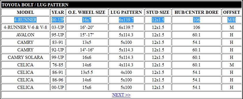

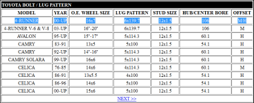

After some more research I found out that those wheels have a +48mm offset. This is 20mm more than the stock 4Runner wheels (correct me if I am wrong). I have a feeling that 20mm or ~3/4" spacers are hard to find and I would like to keep the thickness to a minimum. I am assuming that particular thickness is either too thick to use stock lug studs with or too thin for bolt on spacers. Is this true?
So is it worth it to buy spacers or if I get gm wheels then should I just send them to a machine shop to get them bored out
I like the look of some gm wheels and I would love to put them on my 3rd gen 4runner but do they even make an adapter for Toyota to chevy wheels
