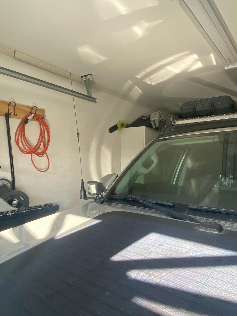

I have my 6DB antenna attached to my rago ditch light mounts with their HAM radio antenna bracket. The antenna tip sits just under the 7’ mark so it will still hit my garage door weather strip, but it’s a flexible antenna so it’s just flexes and fits no problem.
Is there a way to make that antenna straight? That crookedness would make my OCD crazy
Maybe. You'd have to find a ditch light mount that sits parallel to ground. I believe most ditch light brackets match the angle of the hood, which pitches forward... and the antenna's length accentuates that :/.
TBH I don't notice it nowadays, though it did bug me in the beginning.
The antenna also came a little bent out of the box.
