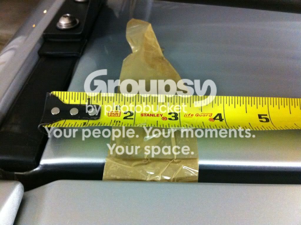

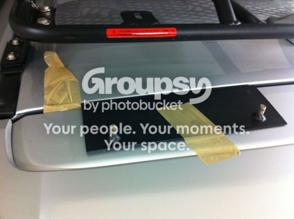

First, measure about 3 and 3/8 inches from the inner portion of the rubber roof gasket.
IMG_1484.jpg~original
Then line up the plate and pull it toward you and tape in place.
IMG_1485.jpg~original

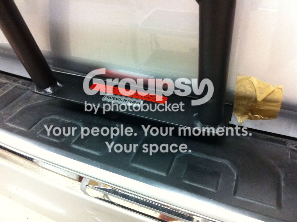

Next, you lay the ladder on the plate and level it and mark it with tape
IMG_1486.jpg~original
IMG_1489.jpg~original
Then you take off the ladder and head back up to clean up the area under the plate and tape it down.
IMG_1490.jpg~original

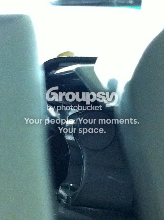

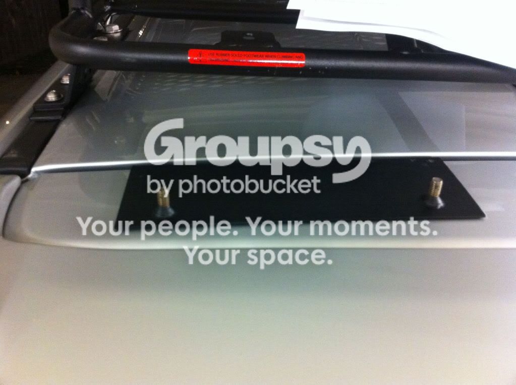

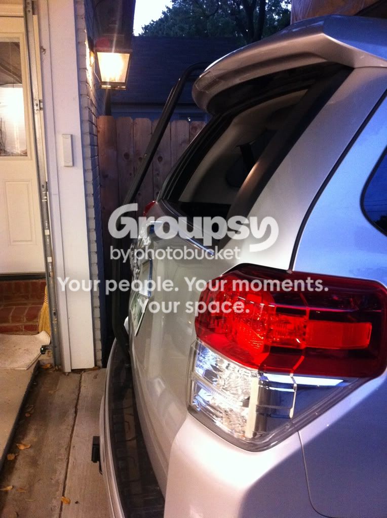

This is where I had some issues. The directions say to pull the plate towards you so the metal bend catches the body work as you press on the double stick tape. The problem I had with mine is that the plate bend rested right on the tailgate hinge and in turn would not lay flat enough for the tape to adhere. I bended the plate a little which initially let it lay flat enough for the tape to stick but then when I lifted the tailgate, the plate lifted up again. This might be because I had to initially restick the tape to put the added bend in the metal once I noticed it, or because the metal was still hitting the hinge, I couldn't tell for sure.
This is after I bent it a little.
IMG_1496.jpg~original
Then it kicked back off.
IMG_1499.jpg~original
IMG_1507.jpg~original
Needless to say I continued on and for now it doesn't seem to make that big of a deal. Either I royally screwed up or directions are made to be broken.

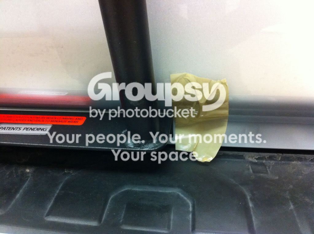

Next, you clean up and tape the metal band on the inside of the tailgate and do the same with reinstalled ladder on the bottom.
IMG_1500.jpg~original
IMG_1502.jpg~original
Then you clamp everything together and finish off the bolts on the top of the ladder.
IMG_1506.jpg~original
IMG_1509.jpg~original

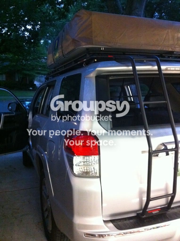

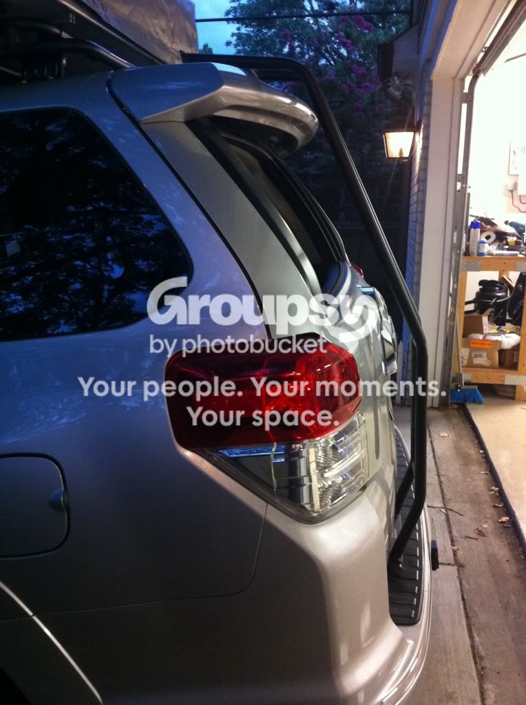

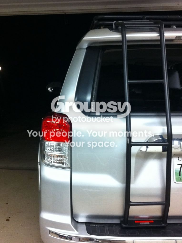

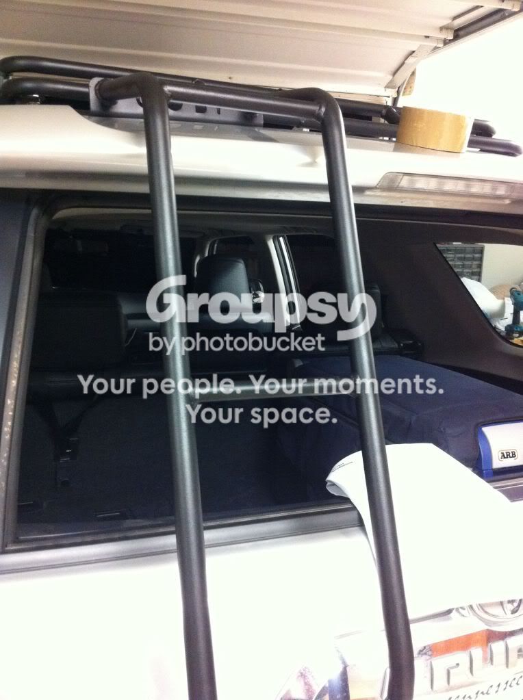

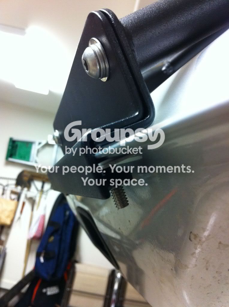

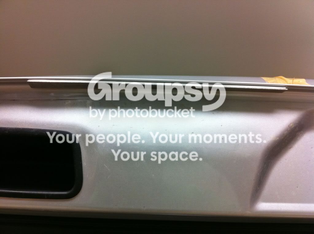

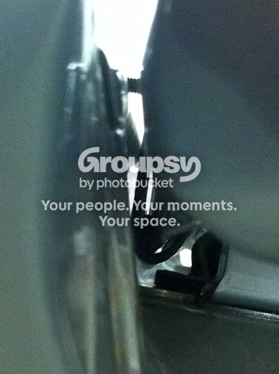

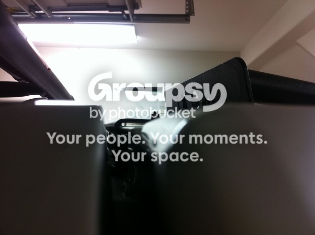

Here are a few more pics. I don't have the directions in front of me, but as far as the struts go, the directions made it seem like you could "request" heavier duty struts from GOBI, but I have not confirmed this with GOBI?
I didn't notice any issues with my shoe (size 10) hitting the tailgate while climbing the ladder, but I would guess that is variable.
e12967c7.jpg~original
Sorry for the poor contrast.
4c36feca.jpg~original
192bd9a7.jpg~original

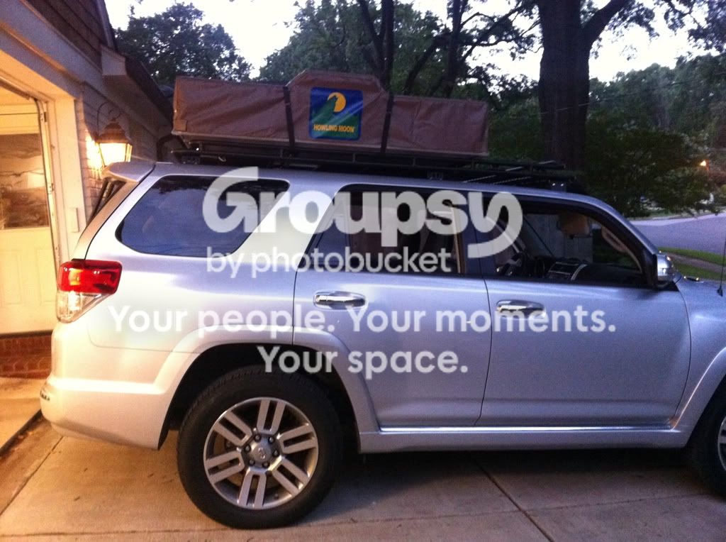

It helps us to have the rear ladder for our roof tent (helps in opening and closing it up, and adds an extra entrance/exit out of the side tent window if needed).
602fcc67.jpg~original
