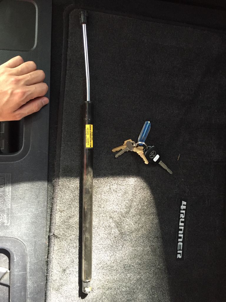

Hello all,
My wife was using my truck yesterday, loaded my daughter in her car seat, then put the stroller and the trunk and when she closed the lift gate one of the struts jammed and bent. This caused the strut to fly off the mounts and out onto the ground and then the lift gate fell down. I called gobi and they said they would send me a new set of struts so that is good. I am concerned now though because the lift gate seems warped and rubs on one side when closing. Not sure if this is because I only have one strut installed at the moment of if the failed strut caused damage. Only way to find out will be when I get the new ones.
Anyway, please beware all of you have these struts.
