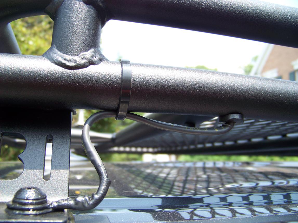

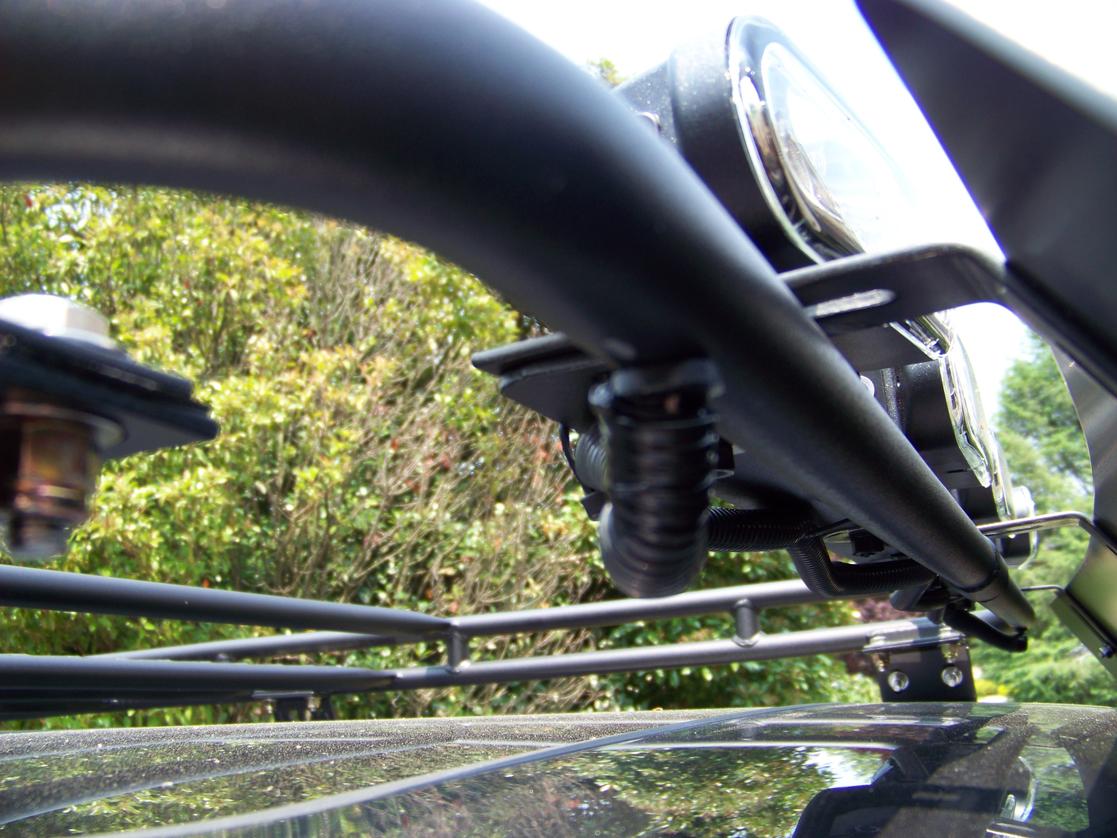

Great info. Just so I understand - if I want to mount 4 lights up front I would need to run two additional wires from front to back?
No- the wires are there from front to back- you will need to run all 4 hot and ground wires from the lights to the wires exiting the front tubes. I guess what I'm trying to say is there isn't a set of dedicated wires for each light, just a main harness. I will try to post some pics for you- or pm me your cell and I can send a pix msg from my phone- I have pics on there already...
Actually, I wasn't satisfied with the smallish guage wiring- it would be great for LED's, but I would like bigger for my quad halogens (Im low tech, so sue me- they were cheap). No worries though, I used both right wires together as my ground, and both left as my hot. The wire IS a good quality... Here are some pics of where the wire comes out in the front- and feeds the lights, and the ground- which I sealed with liquid electrical tape.
