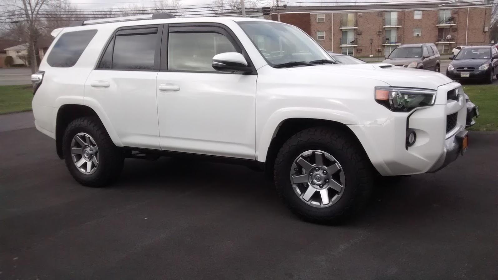

Ever since i saw another members build, i was in love with the Gobi Rack. I just had no idea it would take sooo long to get it. FYI- ordered on Feb-15th. Complete as of today. Pics speak for themselves, you guys let me know what u think?
Looks good. I really like the laces out look of the KO2s. Guess I'm old school like that. It looks good with the black rims and white vehicle.
Sent from my SAMSUNG-SM-G870A using Tapatalk
I love how everything looks, do you have to drill anything to install the gobi rack? Also, how are the new tires better than the stock TRD Pro tires?
No drilling, the directions are horrible to start with, even the print looks like something straight out of the 80"s. Pictures, forget about that, i guess for $1,600.00 nice directions is too much to ask for? I was upset the didnt pre wire the rack for my $1,100.00 light bar that they knew why i was buying it and where i was putting it. After all it is a made to order fully customizable part. I could go on and on but you will find out on your own. Another issue i see is how am i going to clean and wX the roof of the truck, i guess ill have to buy a pole with a thin brush to clean. Also this thing is 70lbs and you do and will feel the extra weight up above!! It will be a good 8-10hr install doing it the right way like i did!! Feel free to ask me anything about install. Paul at Gobi will e-mail you a wiring diagram to help. I took a different path in the engine compartment!!
Looks outstanding!
Really looks good. That will be my next mod. Thanks for the heads up on the ordering timeline - good to know!
Man, nice looking rig. Let me know how that light bar works out for you. I love the look on the white rigs, but I don't want to black out my hood.
Thats Hot. Like the rack but for $200 worth of parts . ouch they make their money , thats for sure.... I run the BF Goodrich ta/ko2 but I turned them so the black wall is out

looking good. man those wheels looks awesome on that car with those tires! got me thinking, perhaps i need a new setup. :nerd: lol

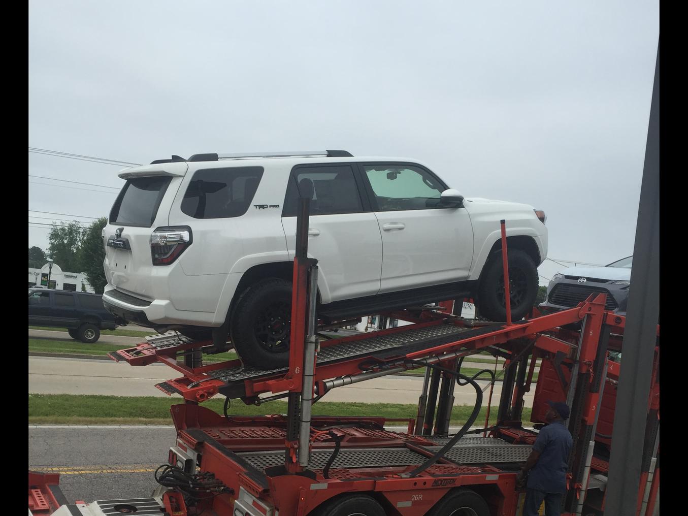

Mine has arrived!! Picking up tomorrow
about $900 off sticker for those that will ask. Thankful I'm not in CA. Although the weather is much better.
