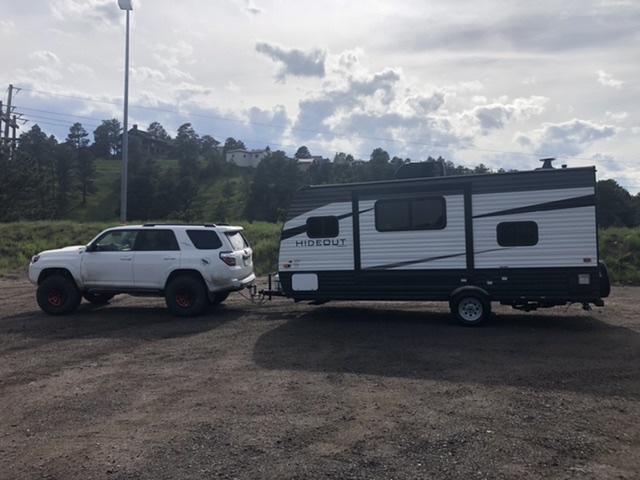

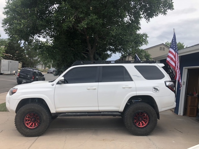

I'm running 35's on my 2019 4runner TRD Offroad Premium non-kdss, with stock gears. I also live west of denver, right along the Rockies at about 6,150 elevation. My rig runs fine, but I plan on a regear this winter, mainly to help with the speedo/mileage correction. I also tow a 17' travel trailer that's 4,500lbs loaded. I can still run it 68mph up the initial climb into the Rockies on I-70 while towing the travel trailer.
I tried the front bumper a little and have no rubbing anymore. Wouldn't need to trim at all woth a high clearence front bumper. The rear I rolled the pinch weld on the fender that's under the weather striping for the door. I do get a little run if doing high speed, big bumps that stuff the tire all the way up but it's very very little now.
FWIW - I don't think re-gear will help with the speedo. It's taken from the ABS sensors IIRC. So it's downstream of all of the gearing. Not really a great solution other than a 4 channel speedometer healer type setup. But I'd think gearing would help with 35's as far as driveability.
I have 285/70's, I have trimmed the front, removed the mud flaps, have UCAs, and do not have an inch to spare. I cannot understand how your 35's are not rubbing. They do look good!
