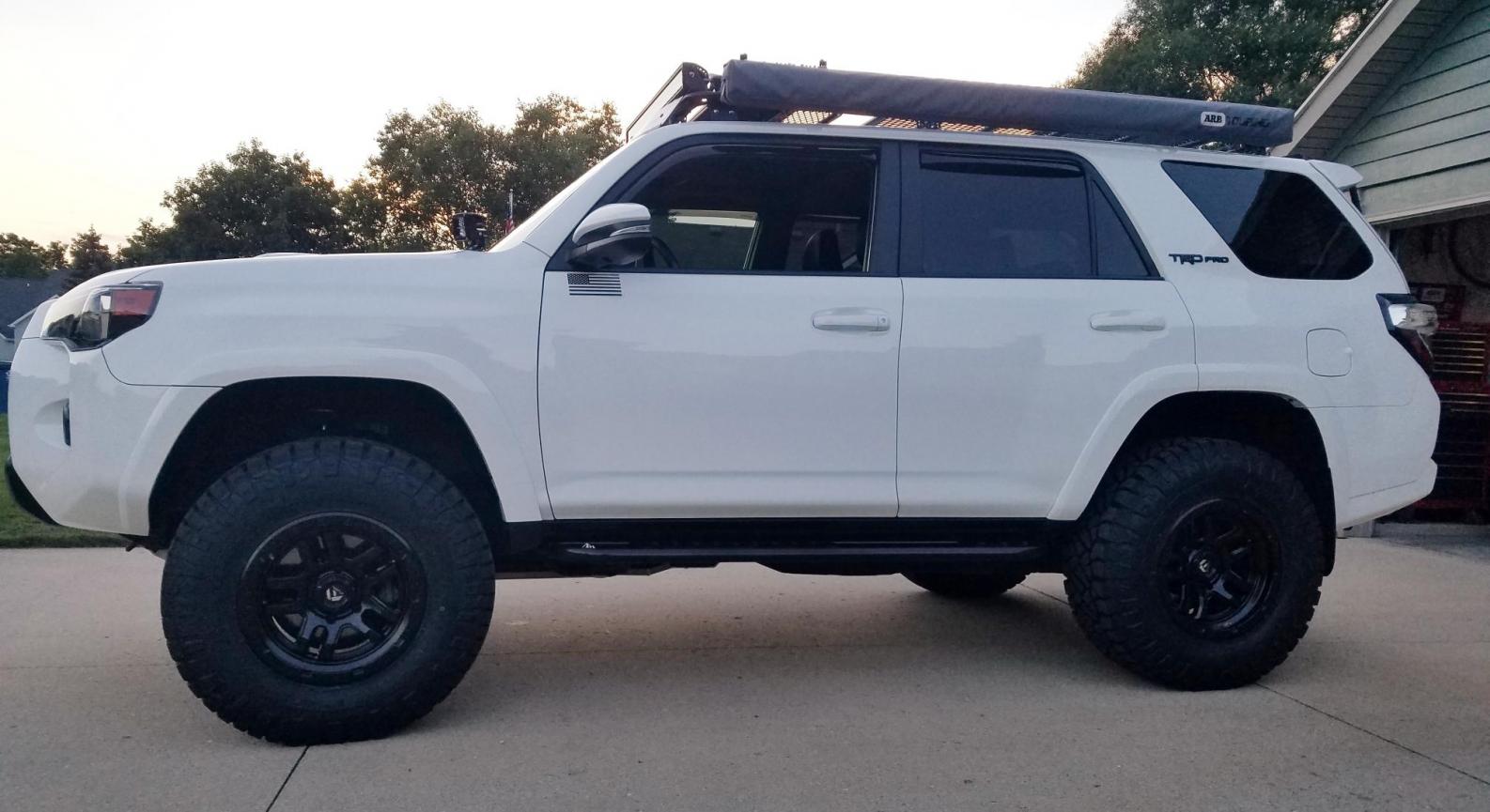

285/75r17 installed
full size spare fits, cleared panhard bar by maybe a pinkys worth of space
What uca's are you running? I have the SPC uppers and you and clock them more forward to allow for the required clearence in the rear of the front fenders.
I figured it would fit if you didn't have KDSS.
Yea..thats the first major let down of KDSS for me. I have seen others (non-KDSS) fit 34s aired down in the spare well with it barely clearing the panhard. The KDSS sway bar sure does limit clearance back there!

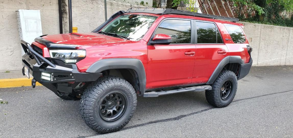

I've got ZERO rub on my body mount with trail/offroad wheels and 255/80s (wildpeaks). Ever so slight rubbing on the drivers mudflap on weird flex when making a left turn, but it's minor at best - removal would solve the issue.
I don't have spacers on yet - I put them on and was rubbing the front fender liner and mudflap decent, pulled back in the garage since it was 10PM pulled them off and they've been in a box ever since...
Also - gas mileage is great on the 255's - I average 20-21 on my commute to and from the office - running 65-75 (70 miles round trip)

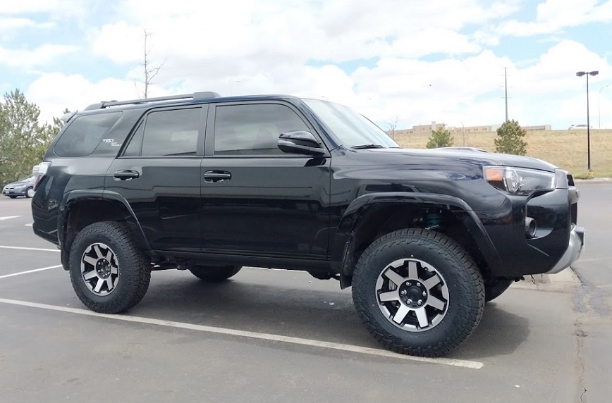

A year later and I finally took the plunge. Same Nitto but in a 285/75/17
