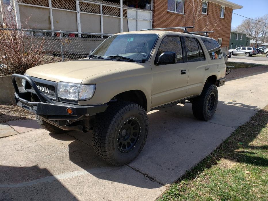

I went from white to sand. Door jambs and other parts are still white. I mainly just did it because my white paint was faded and dull and I didn't want to deal with it.

this is what i did so far
