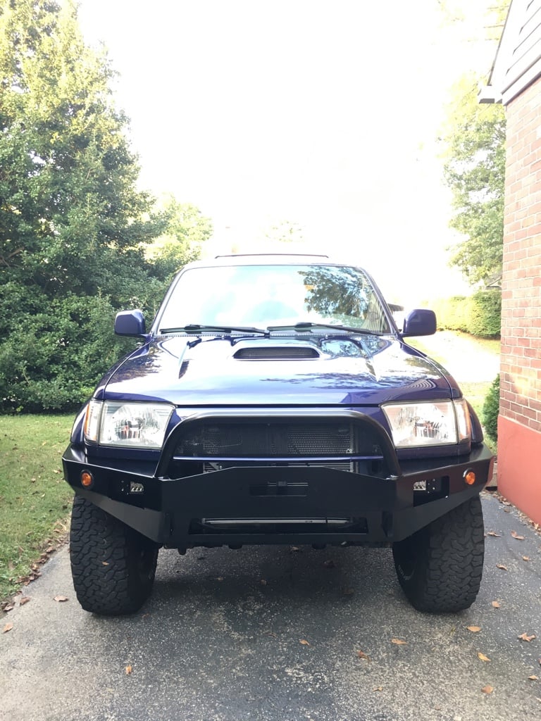

Finally got the plate bumper installed and am going to install the winch once the synthetic rope gets here. Since the battery is from 2007, I figured it would be time for an upgrade.
What's everyone's recommendations on a good AGM battery that will handle the winch? I also plan on running LED pods front (installed) and rear, along with a small light bar.
