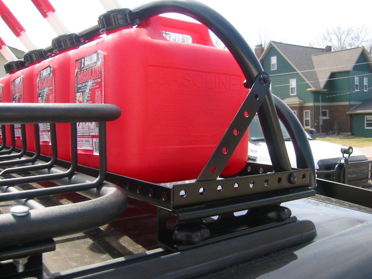

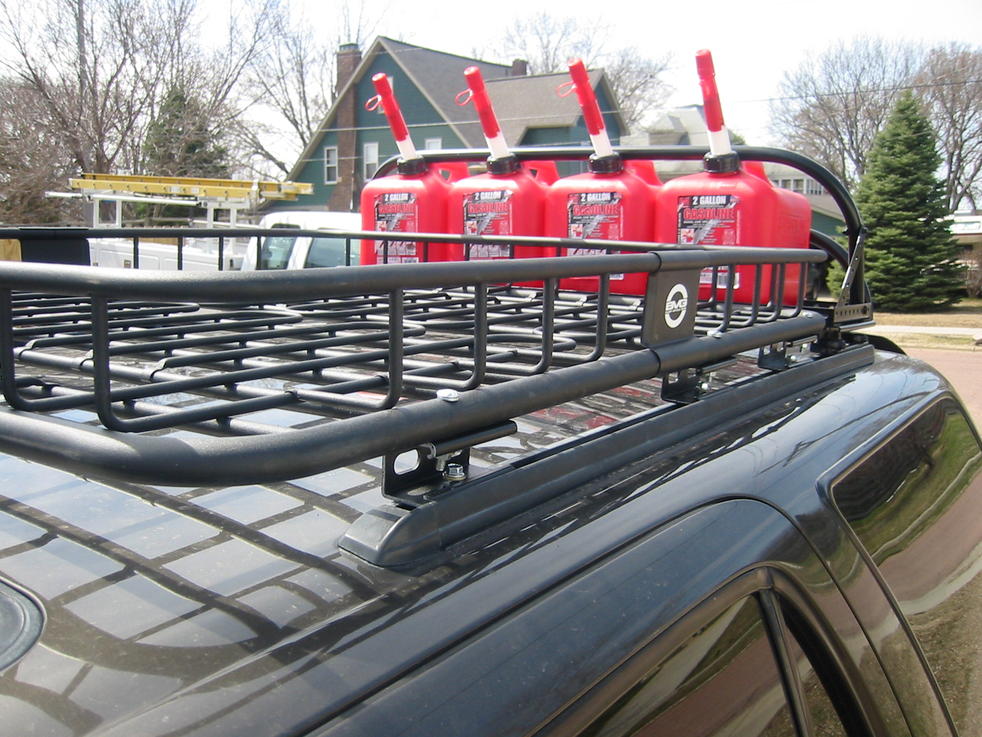

That's the rack I picked up. It works great for me. I built some custom brackets out of uni strut. Brought it down to about an inch above the roof. Turned out great.
Here's a couple pics of the uni strut I used

We always have a bunch of scrap laying arond at work. You can find it at any home improvement store. Lowes Home Depot
I'm going to do something similar, but I think I'm going to just bolt mine directly into the channel using some large stove bolts. As long as the head is big enough it should be plenty strong enough and will provide the lowest profile. I'm hoping this helps with the noise, too. Will post end results. :D
durrell, I tried to get mine as low as possible. If you bolt your rack directly to the roof rails it will hit the roof due to the curved profile. I made mine an inch above the highest point of the roof. It will give a little bit of flexing area when its loaded. Just wanted to let you know before you buy all the parts
Sorry to bring up an old thread but I have been trying to find out a way to lower my roof basket and the way you have looks a lot lower then what I have now and was wondering if you could tell me where you got them. Thanks in advanced
