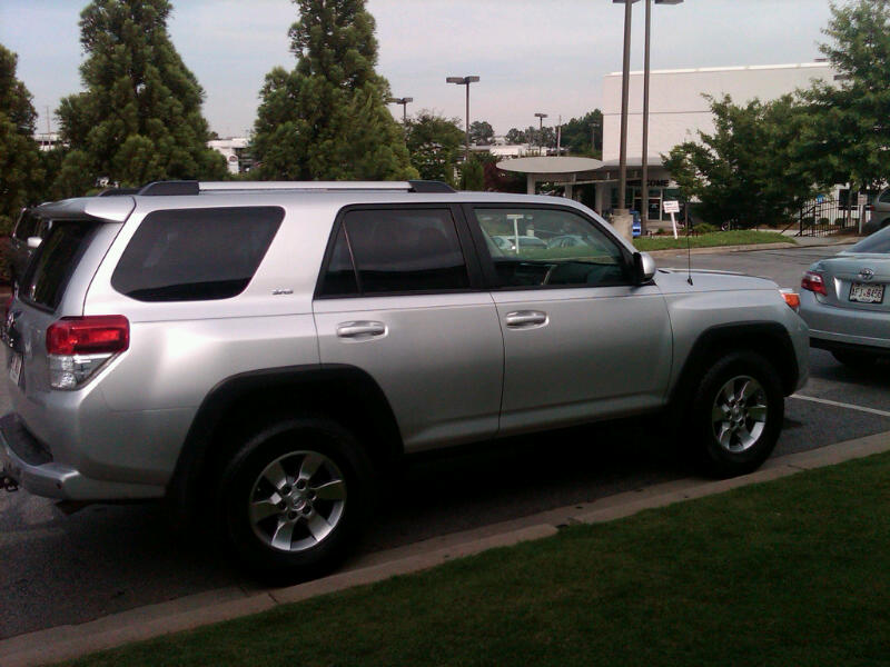

"engine types" seems odd: the V6 is essentially the only engine. has anyone actually ever seen a 4-cylinder model in person?
Yeah I have seen three at my dealer in Atlanta, Proof Below
