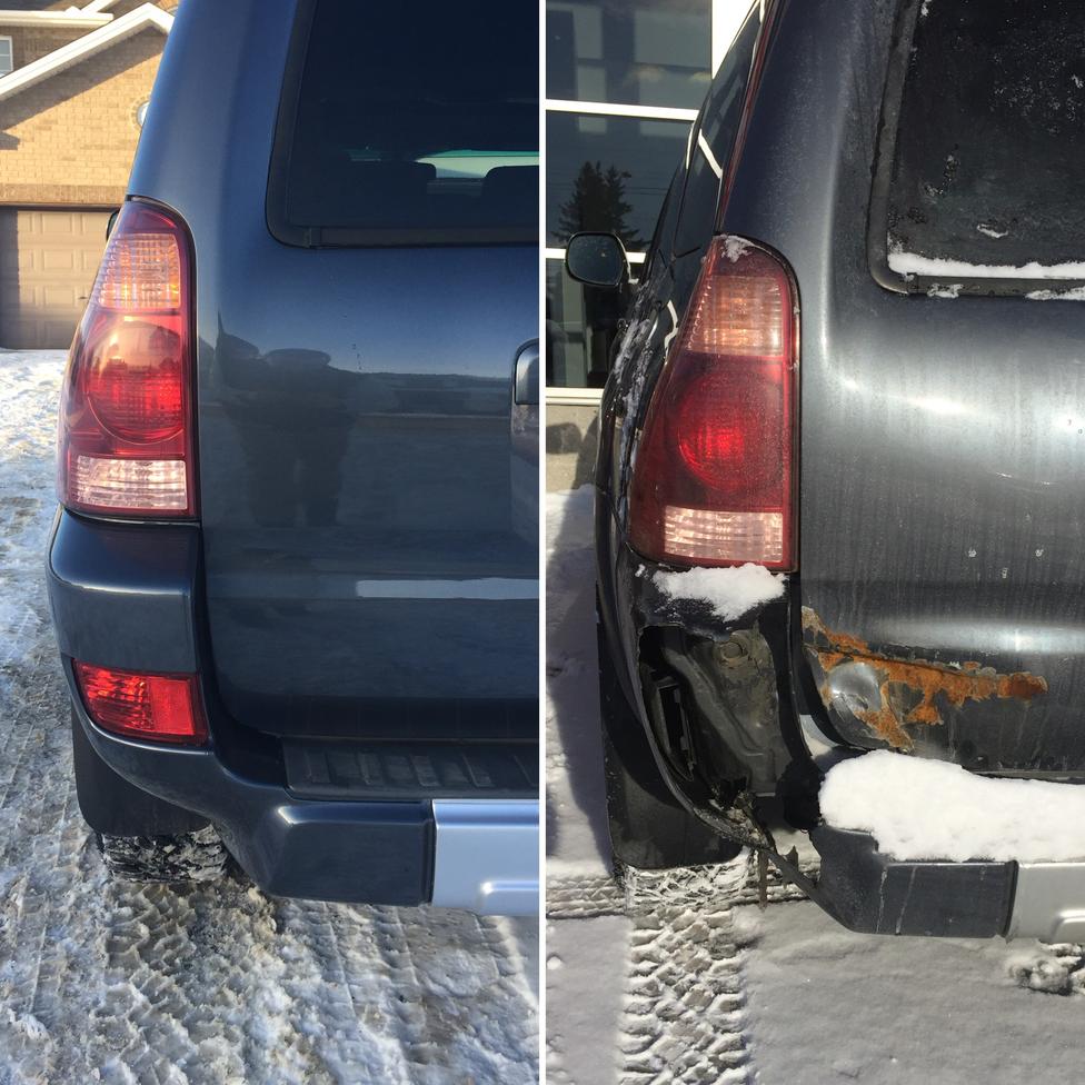

Got rear ended. Would like to rebuild myself. Need help

I had similar damage done to mine on new years day... just my luck. i had the work done by the dealer and it cost roughly 4000$ (canadian) the hatch was replaced along with the corner of the bumper and centre section.

Is there any damage to the body itself? If so, that may be a deal-breaker for a DIY fix.
I replaced my back hatch after a Uhaul trailer came unhitched when loading (their fault), and their insurance just wrote me a check. So I went to a junkyard, found a good condition silver hatch for $350, and pocketed the rest.
I fixed my rear end collision similarly, except it was $750 for a good used liftgate in my area with some of the yards asking $1200-1500. Got the right color and bolted it up. Mines a 2003 with the untainted bumpers which are available aftermarket pretty reasonably and no paint required. Not a very challenging job if you're handy.
