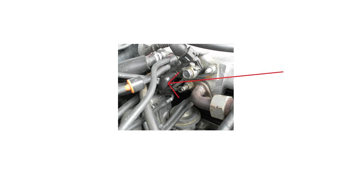

So i took apart the cold start injector and cleaned the injectors, still didnt fix it there is power getting to it, and the resistence is good, but i looked and under the CSI there was a vacum hose and it seemed to be cracked and folded alot, the PO did this, i was wandering if that was the problem....here is a picture:
i cant find what this hose is, dam!!!
