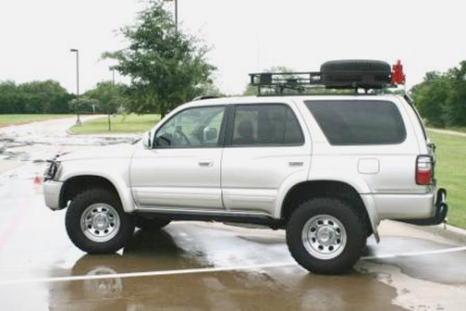

Here is my 02 runner with the Daystar 2.5" on the front, and the OME 891 coils on the back, which is also about 2.5". I do some offroading though, so if you are limiting it to a DD and just want a more aggressive profile and look, I would do 1.5 - 2.0" on the suspension. If you go that much on the body lift, it will entail adjusting your radiator, steering, transmission linkage, bumper, etc... You can get a Daystar 2.5" lift (spacers) for under $200.
