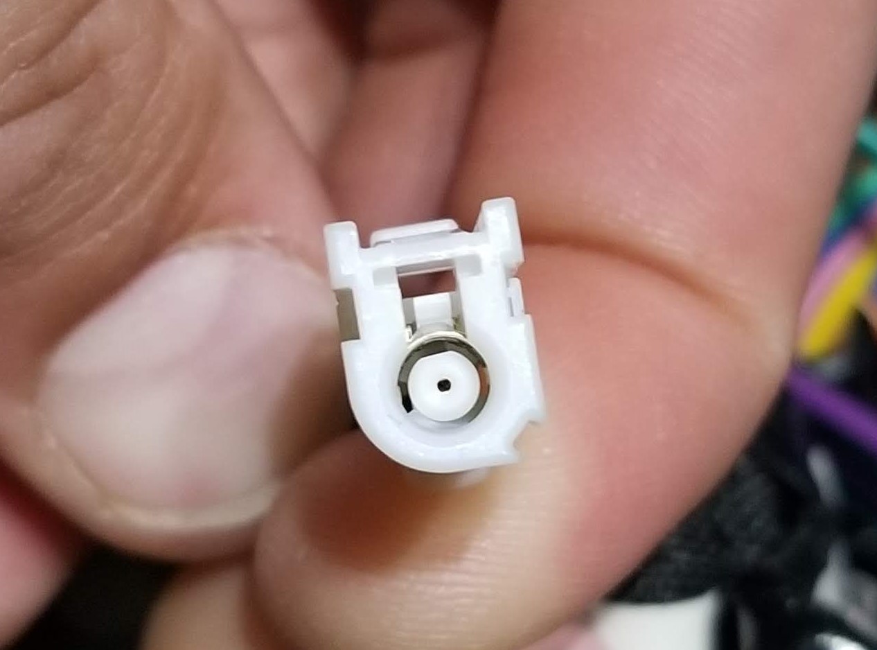

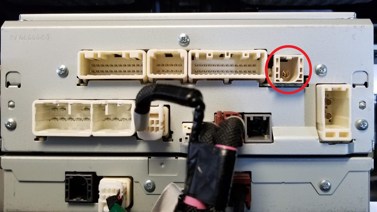

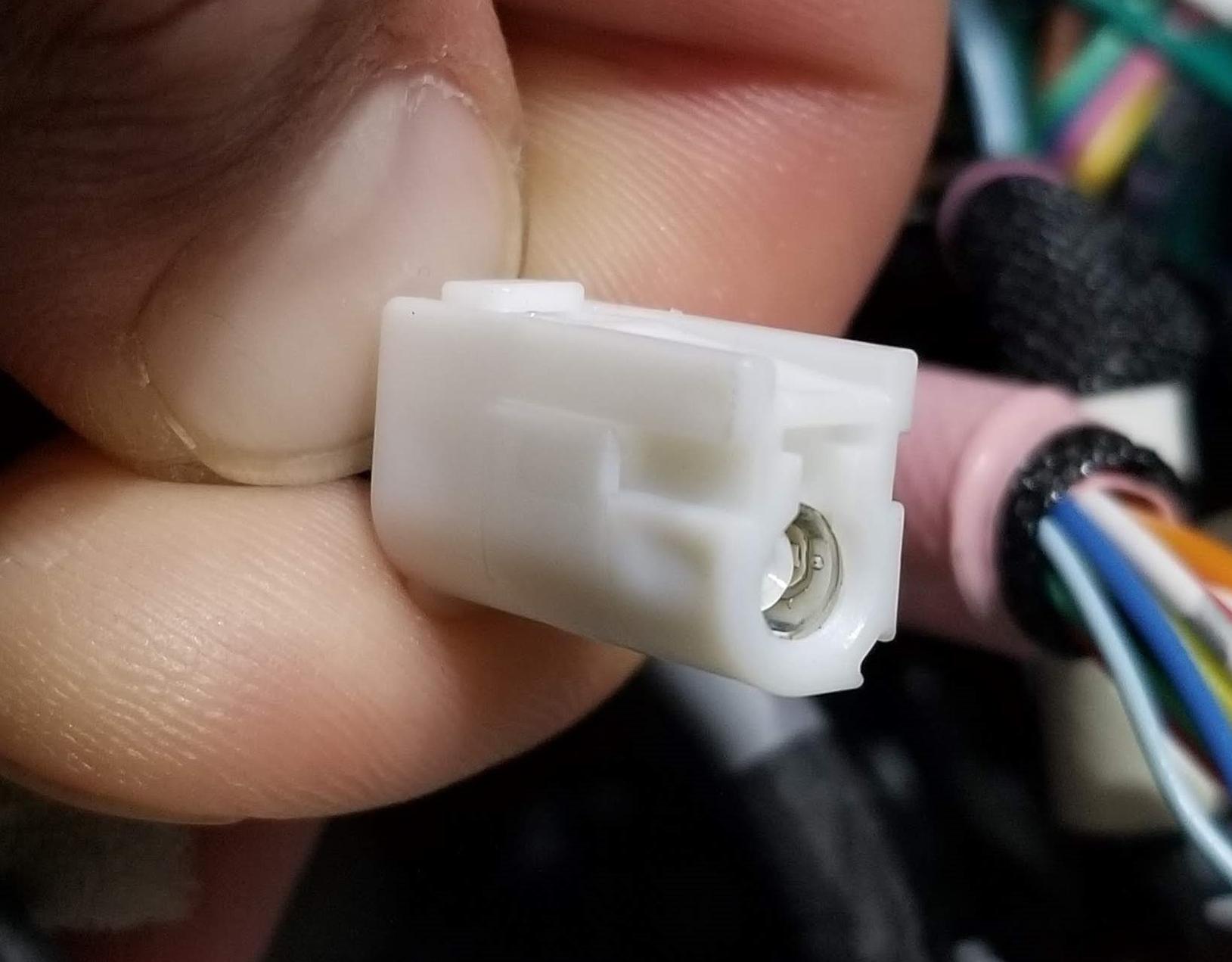

Anybody know of an adapter to go from the stock GPS cable to an aftermarket head unit requiring SMA?
This one almost looks correct, but the center doesn't quite look compatible: https://smile.amazon.com/Electrical...534638917&sr=8-5&keywords=gps+antenna+adapter
Here's a pic of the back of the stock unit with the GPS connection circled. Also pics of the connector I need the adapter for. Anyone have experience with this?

https://www.amazon.com/iDataLink-Maestro-ACC-SAT-T02-Satellite-Antenna/dp/B01K03PORU
Not really needed though. The OEM GPS antenna is just 6 inches further back in the dash stuck to a metal bracket under the top dash pad. Just stick your new antenna in the same spot. Applies to 2014 - 2017 5th gen.
I was thinking that myself. I was just looking to get the cleanest install possible, but if the one that comes with it is just as functional and it's that easy to place, then yeah, I'll just save the $28. Thanks!
The new one will be 12ft or more of cable and you only need about a foot. Coil up the extra and don't put any sharp bends in the extra cable and you'll be fine
