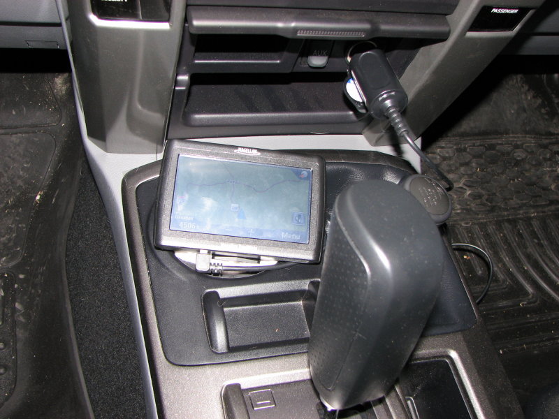

I've got a $100 Magellan that I wrap with a sweat sock and stick in the cup holder. I wouldn't recommend mounting it so far away from the windscreen area though, if you need to view your GPS a lot while driving.

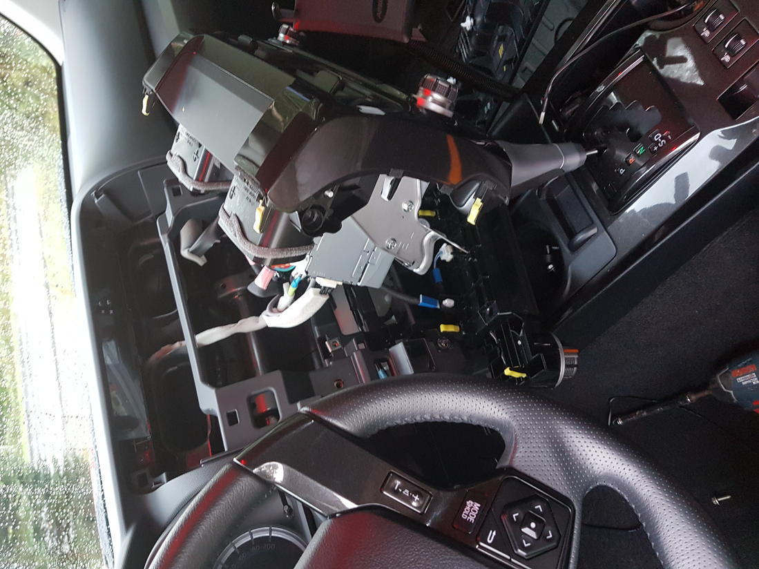

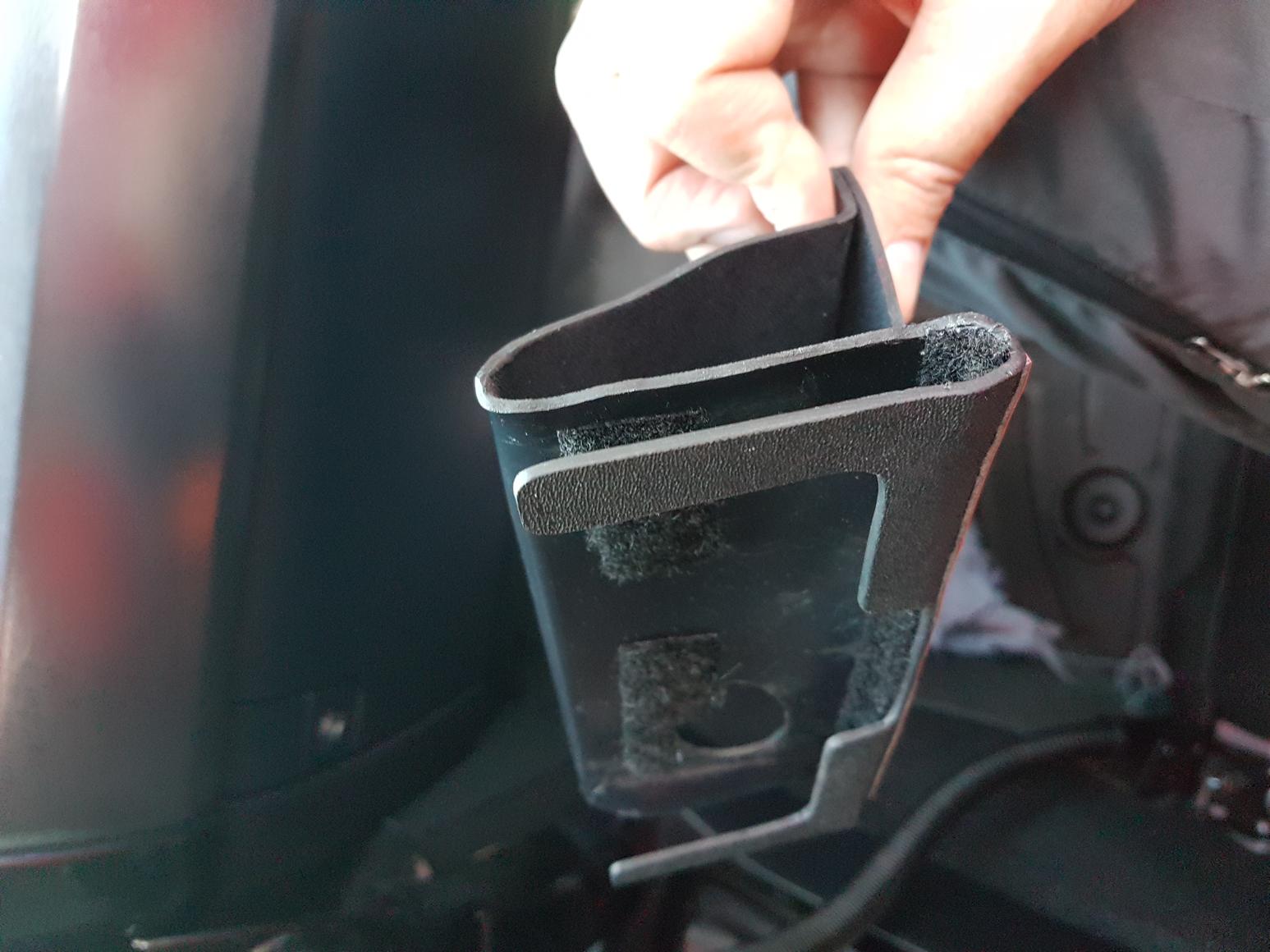

Made a custom mount for my Garmin nuvi 6". Made it out of kydex.. Heated, molded to fit.
Removed the head unit to hide the wires, installed a 12v socket near internal fuse box.

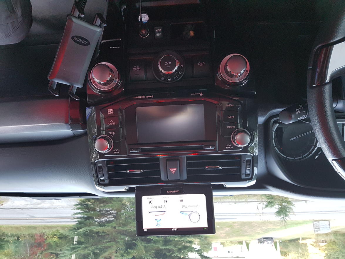

I have the factory nav. But it sucks and I'll be damned if I pay $400 to update it. My Garmin has lifetime map updates AND my backroads map book offroad maps on it too.
Mount is. 08 kydex heated to 400 degrees and molded to GPS and mount location.
Not a professional job but I'm happy!!! GPS is removable (Velcro inside mount to hold GPS firm). I don't miss the clock. Just added clock to my Garmin screen.
LOVE the location!!!!!

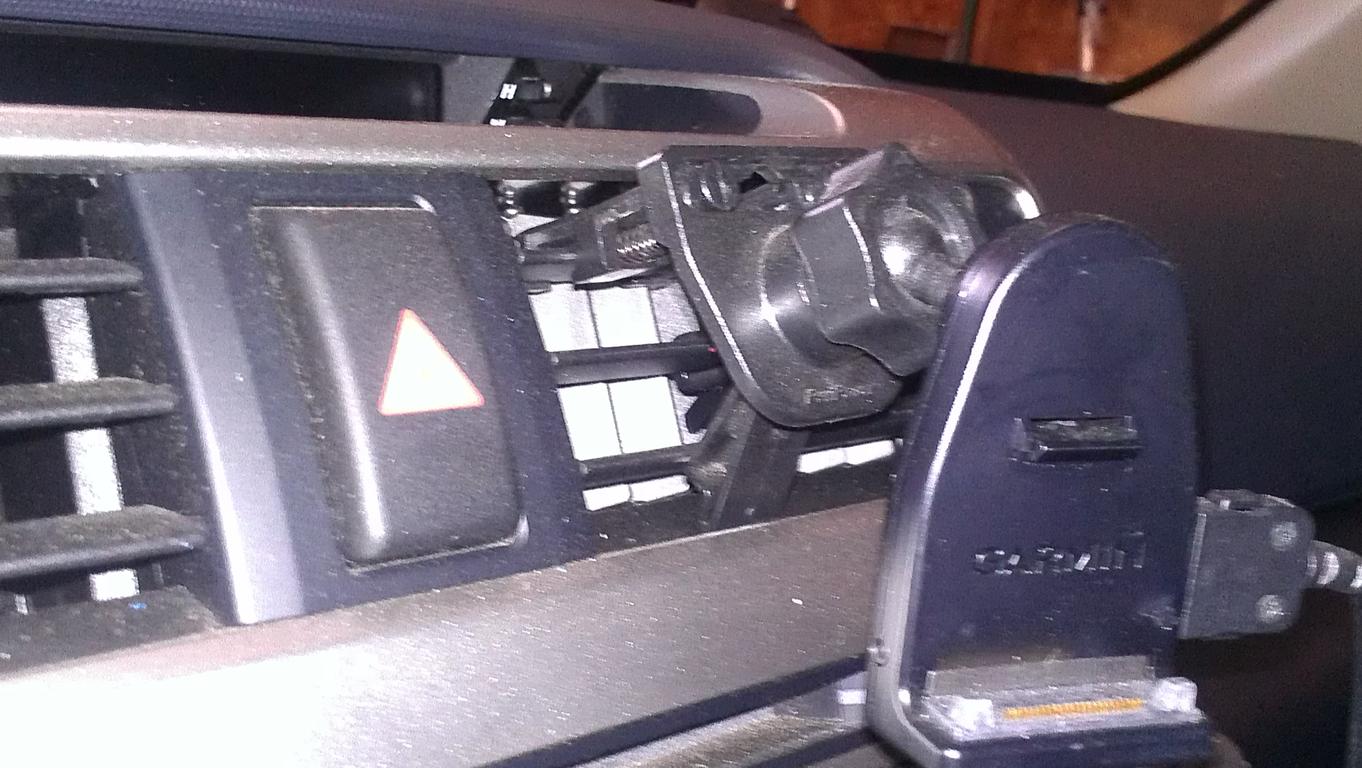

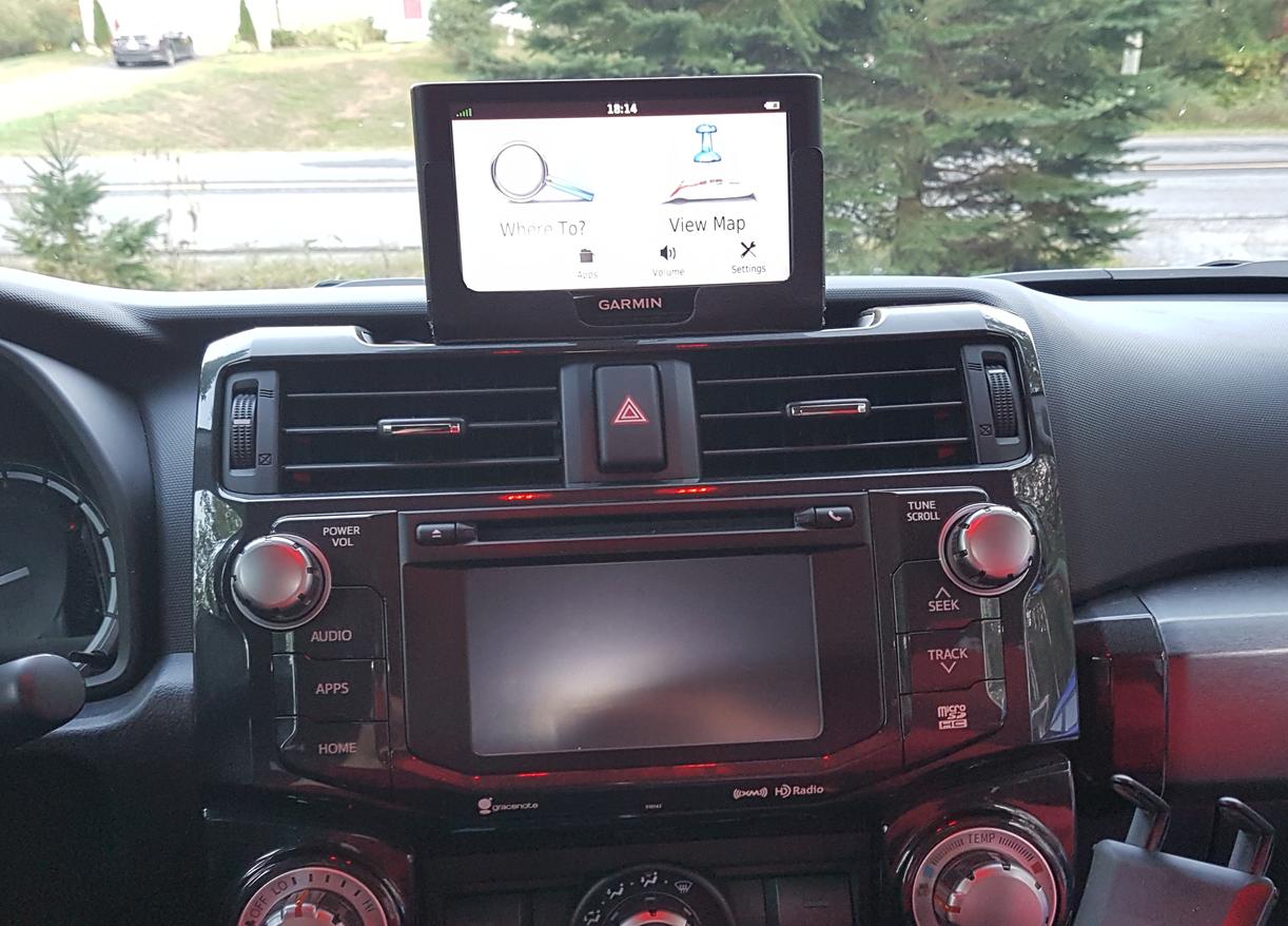

I have my mount for many years and I think it's the best GPS location. It doesn't interfere with any displays and controls, doesn't obstruct my front view and It's easy to see with minimum distraction. Mount itself (on last picture) costs probably under $10 and I think I got it on e-bay long time ago. Like maybe 10 years ago or more. I got a new GPS since then and just removed old Garmin bracket from the mount and put a new one. Nowadays I would try to get it on Amazon and read all the reviews. Some mounts are garbage, but this one has springs in the mounting arms and I have no issues with it, holds very well on all kind of bumpy roads and trails and not very hard to remove. And I like vertical GPS map orientation because I can see more of road ahead.
