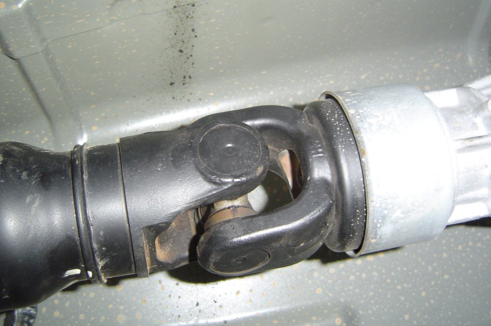

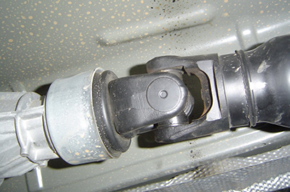

Is there anyone out there with a V8 2WD that will look at their driveshaft and confirm that there are no zerks. Maybe someone out there has a camera, too.
It's possible that Toyota uses the so-called lubed-for-life U-joints on the 2wd
4Runners. In which case, you would have no zerk fittings to lube.
Those pictures show a slip-yoke at the trans. output, so no slip-joint to lube.
There are no Zerk fittings visible in those pics, you would have to turn the driveshaft to make sure there are no zerks just opposite of the spot visible in the pics.
I would suggest calling the dealer service writer, and have him ask a mechanic if the 2wd 'Runners driveshaft is sans zerk fittings.
The driveshaft was turned from first to second picture and there are no zerks. I was just thought someone would know for sure. The dealer, in fact two dealers had the same answer, 'huh'. I'm beginning to fear the dealer if anything is the slightest bit out of their normal change the oil, read the computer and wash the car.

The bottom line, your driveshaft is zerk fitting free. So you don't need to worry about the U-joints until they eventually wear out.

So, it looks like 4wd has zerks and 2wd does not. I just wish there were other 2wd owners that could look under and confirm that they have no zerks. How 'bout a picture from a 4wd driveshaft. I showed you mine, where's yours.
Well, other than the dirt, they are fifferent. And with a couple of photos we've gone where service writers have never been. Now we need another 2wd owner to chime in with a photo. And, oh, by the way, I'll clean up those dirty spots and that 'ring-around-the-collar'. Is the shinny spot on your drive shaft larger because of the lift kit?
