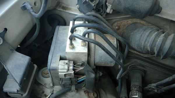

So those 4 lines that are on the passenger side in a loop are for the rear heater? Cuz I thought they were brake lines too.(I'm in the same boat as you sort of) Did you take a picture of it?
Sh*t that's what I thought, was just holding out a bit of hope. I'm not looking forward to fixing it.
Just to be clear, you are talking about this right?
No, the ones that rusted on me are visible in the very lower right of your photo. If you follow them down they go alongside the frame and back into the body near the rear seat.
I am certain they are coolant. The ones I pulled off the 2002 spewed bright green coolant.
Nope. There are four lines running parallel to the ground along the inside of the frame they loop together so it's technically only 2 lines but it looks sort of like this.
