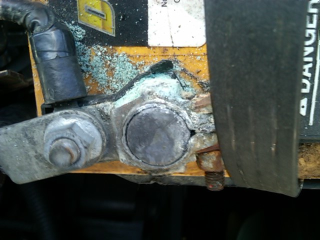

So for the past month my truck (96 LTD 150K miles) has been giving me a hard start. This past weekend it decided not to start at all. I changed the starter about 2yrs ago. I can't exactly see if there is an issue with the starter as easily as i'd like.
Opened the hood and saw this green dust. Could it be a problem? The battery and power inside the car (radio, clock etc) are all working fine.

I just replaced the original battery on my V8. There was a little green corrosion on mine as well but not as much as yours. The guys from Autozone gave me a couple of red felt-like washers that you put on each terminal of the new battery before putting the positive and negative connectors on. Apparantly those little red felt washers are used to fill the open space on the terminal and help prevent the corrosion build up you pictured. Of course I bought the little packet of vaseline and smothered everything afterwards.
A little baking soda does the trick. Just had that stuff accumulate on my battery and no biggie!
I used to pour a little Coca-Cola on mine. Now I use the lube and pads from parts stores like everyone else is talking about and haven't needed the Coca-Cola since.
