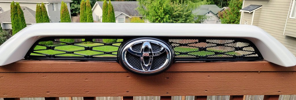

So here's my first section with the aluminum mesh that I linked above from Amazon. This is the 3mm x 6mm so it's relatively small but so is the wire so I can't see it restricting airflow in any significant way.
I took the top portion out to make it a little easier to do, I'm not sure if the bottom grille pops out or not but I'm doing the top first anyway.
IMG_20191003_094228 by Michael Starmer, on Flickr

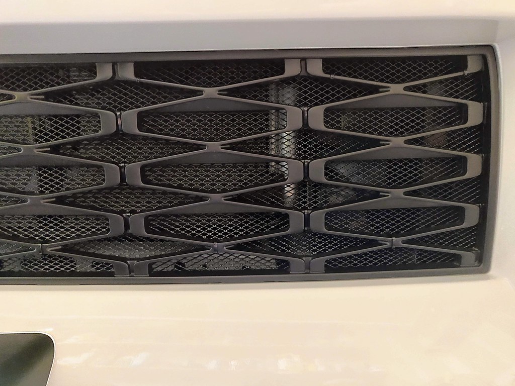

All done, it's attached with small black zip ties, a lot of them...
Definitely more work than I thought it would be, removing the top portion made a huge difference in how hard it was to do the bottom. I just made a cardboard template of the top and put down some painters tape on the mesh and cut it out with tin snips. The bottom was pretty much a rectangle 37.5" x 7" I think. A little tough maneuvering into the right position but once it was in there I just started placing zip ties from the middle and bottom working out towards the ends.

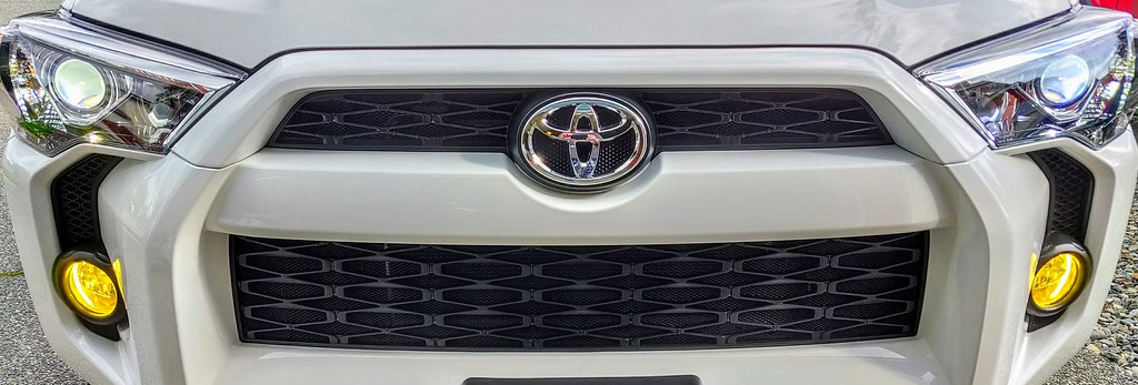

Here's the finished product. Xenon Depot HID kit and yellow LED kit. IMG_20191003_131850 by Michael Starmer, on Flickr
