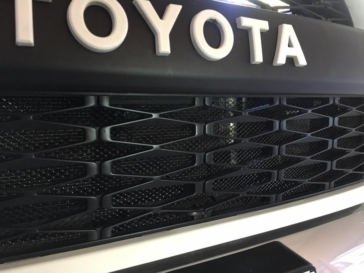

Here's mine

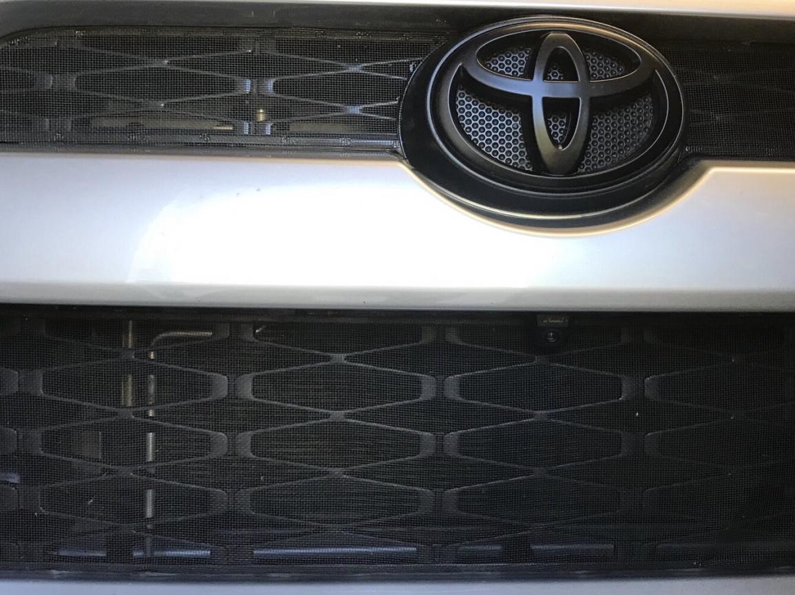

I was so plagued with radiator bugs this spring that I installed nylon window screen mesh on the front surface of mine. I wanted a flat surface to be able to clean it with a soft brush and not have to dig out petrified bug carcasses with toothpicks from all the nooks and crannies if it was installed from behind the grille. Plus the wind pressure keeps it place rather than having it bow inward like a sail if it was attached on the inside. After 2+ months and many high speed miles it’s still in place and working well.
Here’s a link to some more details:
Bugscreen for radiator grill

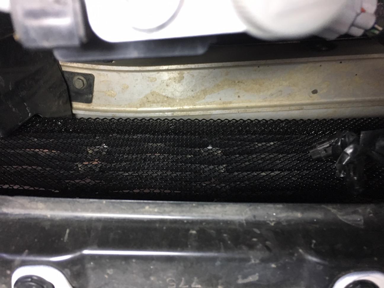

Brilliant idea. I found a 3’ long metal gutter guard screen in black at Home Depot for just over $3 that fit in nearly perfectly behind the lower grille without the need to cut at all. Since it is metal, it can be bent slightly to mimic the shape of the front clip and for the most part it wedges in to the space on its own without need for much attachment to hold it in position. I added a few zip ties around the edges and I’m good to go. I don’t see much need for adding mesh behind the upper grille since it doesn’t open directly onto the radiator condenser anyway. I used the opportunity to brush out the bug carcasses from the radiator while I had the shroud off. Yuck.

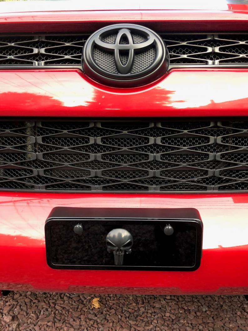

Installed this a few weeks ago and it works great! You can't really even see it until you're really up close to the front end.

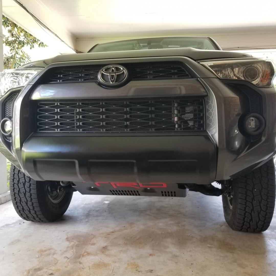

Here's mine. Why this isn't a factory option i'll never know.
