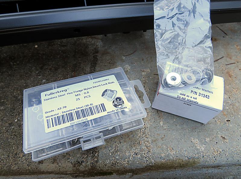

Did you ever end up trying the non-oem nuts for the grille? I'm in a similar situation now trying to change my grille and need a solution for new nuts.
Yep, sure did, Boilas. Measured 'em to the best of my ability and (amazingly enough) they worked great. :lmao:
Here's a photo of the nylocs and washers ordered off of Amazon, showing part numbers. Note that you'll need both... The nyloc bases aren't quite wide enough by themselves to hold without the washers, but their threads fit the bolts perfectly.
Links to the Amazon parts:
Washers (20 washers = $4.20): Amazon.com: Hard-to-Find Fastener 014973448349 Fender Washers, 5mm x 15mm, Piece-20: Home Improvement
Nylocs: (25 nuts = $10.99): Amazon.com: FullerKreg (Pack of 25) M5 x 0.8 A2 Stainless Steel DIN 6926 Hex Flange Nylon Insert Lock Nuts, 18-8 Stainless Steel 304, Bright Finish: Home Improvement

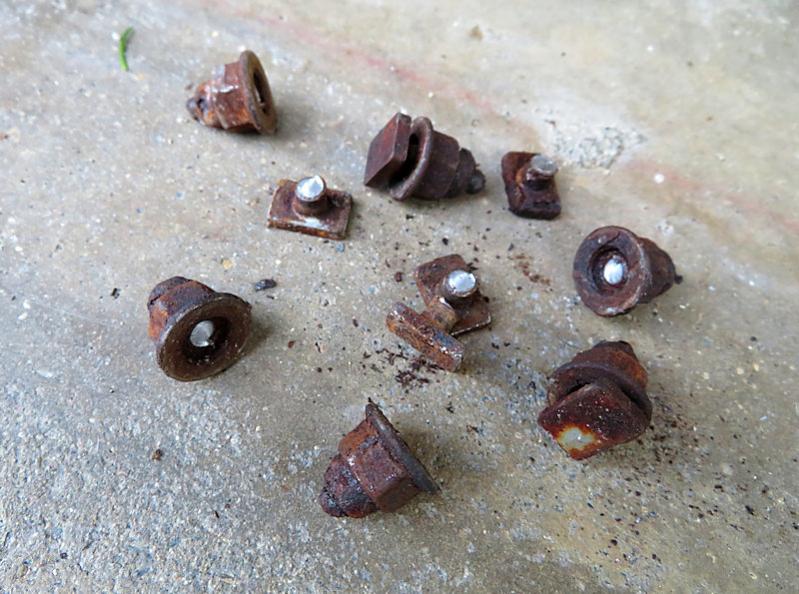

Bumping this old thread.
I assume the easiest way to deal with these stuck nuts/bolts (that now spin) is to dremel them off at the nut and order new hardware?
I was able to get 2/8 off but stopped until I can order new bolts/nuts.
All these to replace the grille insulator piece that had started to deteriorate...
