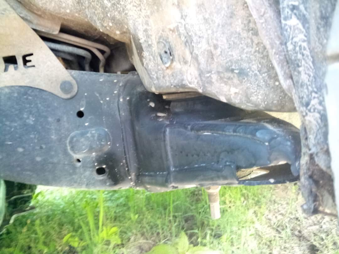

the easy fix for the body mount is to do a body mount chop. A quick google search will pull up pictures of several different methods

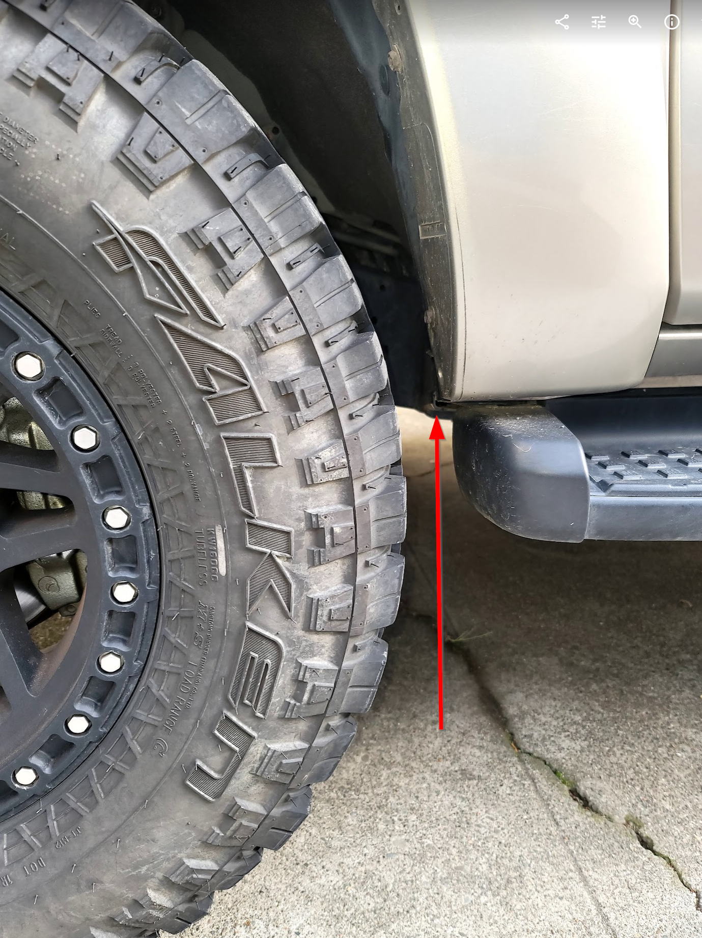

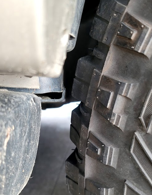

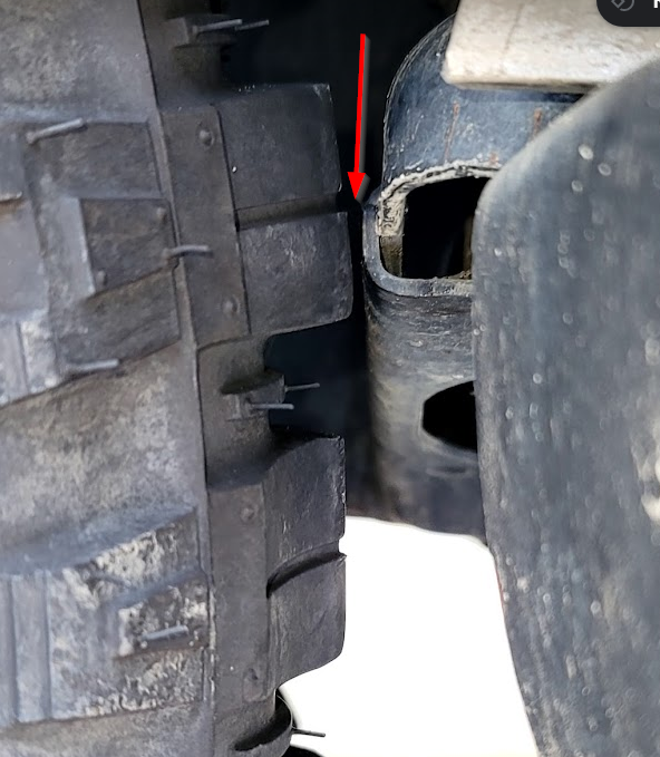

Investigated my wheel well as some of you have mentioned, and I think I narrowed down culprit - wheel is indeed rubbing on frame during braking + turning.
Here's my driver-side front wheel, with no turn applied:
Here is what that space looks like with tire almost fully turned to left:
  • This is about a 3mm gap - so under braking (or hitting a dip off-roading), the frame pushes forward to rub against the 33" tires
For comparison, here's what the corresponding gap of the front passenger-side tire looks like, with wheel turned almost fully to the right:
  • That is about a 6mm gap
Unfortunately, since this is metal frame area we're looking at here, it's not going to be as easy as cutting or modifying some trim. I don't think this is a job that I can undertake to fix myself - lacking both tools and expertise.
I may just have to live with the occasional noise...

Did you watch that video I posted right above your last post. I literally did that in about 15 minutes per side. If you have a buddy with a welder I'm sure he'll hook you up. I couldn't deal with that issue off roading all the time and I just like things done right. Your tires probably don't enjoy it much. I run wildpeaks too. Did your lift come with aftermarket upper control arms to correct caster?
Oh shoot! I only just got your video working - your original link was a mobile-version facebook link which looks like crap on a PC. I edited the m. to a www. and I just watched it.
So that's what it is - a "body mount chop"! :embarassed: This is my first off-roader so lots of stuff is new to me, in case you couldn't tell.
Sadly I don't have a buddy with a welder, and even if I did, I don't trust myself to do this right. I'll sit on this for a bit, and then take it to a 4x4 shop for a BMC if I think it's worth it. According to this article - if it's around $200 I'll just pony up the cash.
