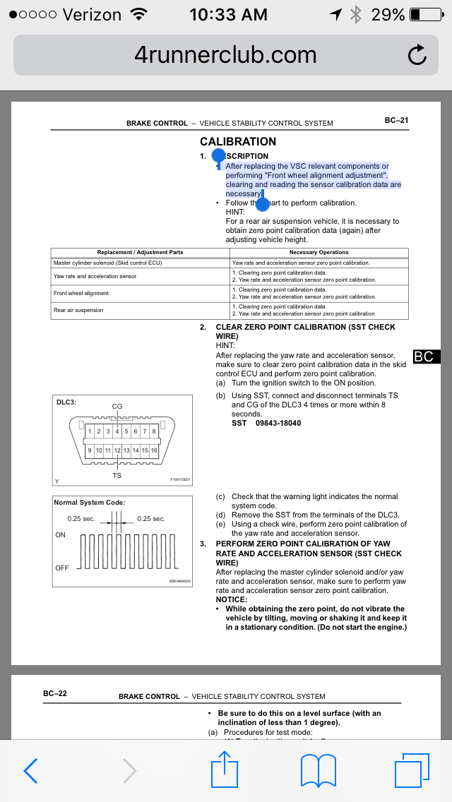

I would look into this, i dont think your grinding is actually grinding just the abs doing its job. The vehicle is preset with certain values it's looking for and bigger tires and more offset wheels are making it confused and it feels the need to correct your driving
Just greased the steering end stops. I'll have a buddy check the wheel bearings. See what happens after those. If nothing then the zero point calibration. Would the rig benefit from a zero point calibration anyway? After a lift,rims and tires?
yes, the brains on the truck still think its stock rake, stock height, stock width and stock tires. The vsc is thinking everything thing is factory. An easy way to test this is to unplug a speed sensor and drive it in a way that you noticed it had an issue and see if you can replicate the problem. By unplugging the speed sensor you will get the slip light, abs light and vsc light and noth of them will function so no beeps or throttle cut off when it "thinks" its slipping. Now after you plug it in you will have to do the zero point calibration to get thors lights off. When i lifted my truck i replaced my wheel bearing and never bought the tool to tighten the nut for the 2wd hub nuts and smacked the magnetic ring on the bearing with a air hammer so the speed sensor wouldn't read. I loved that i had no driving aids besides the auto lsd but it was time for a inspection and had to replace the bearing to turn off the lights and did the zero point calibration lights off, passed inspection and have random times where it thinks its lost traction on sharp right turn.
