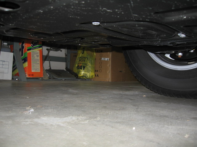

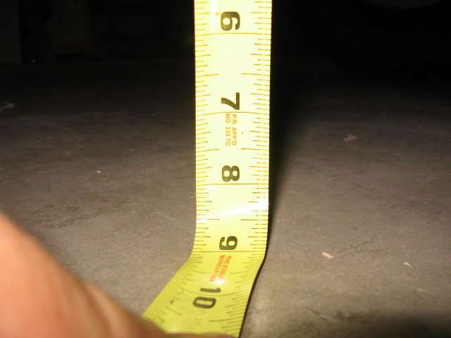

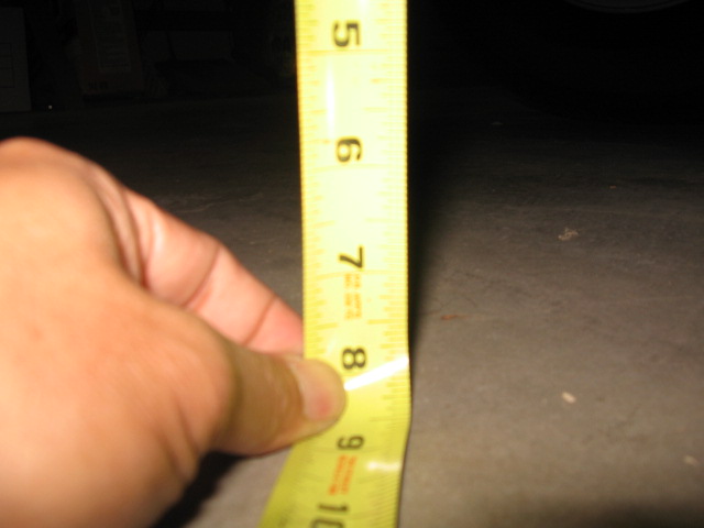

Here you go....The measure was done right underneath the engine skid plate.
One was measure from the plate to the ground (8.5") and the other bypassed the plate (almost 9")

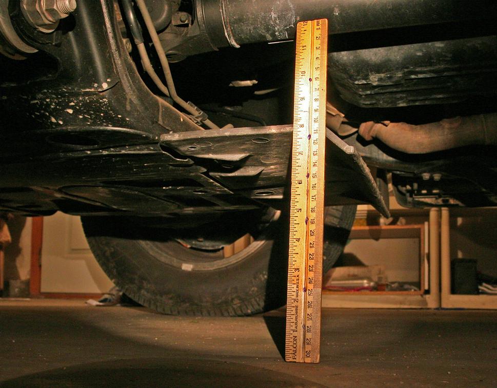

Thanks a lot! So I guess toyota has equally LIED about the numbers. Here was my 06 limited. 7" when I thought I was getting 9.
Since then that plastic (useless(?)) piece has broken off somewhere off road.

Also take into account that the 4th gen used 265/65/17's and the 5th gen uses 265/70/17's. That alone would account for the .5" increase in height claimed and probably the increase in approach and departure angles.

adkinsadam1, i would not worry about the lip at 7"...i would count where the actual plate is...around 8-8.3"...and this is your actual ground clearance. Lexus website correctly states the GX470's clearance at 8.3"...it is pretty obvious that Toyota lied about the 4th gen 4runner's clearance since Lexus is correct. (Both 4th gen and GX share the same underbody [for the most part, other than the optional KDSS on GX] and tire size.)
So, the new 4runner has about 0.5" (+/-) on the 4th gen due to bigger tires. Like i said before, the 5th gen is really a big makeover rather than a true full redesign from head to toe.
