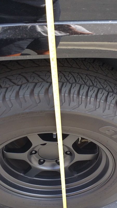

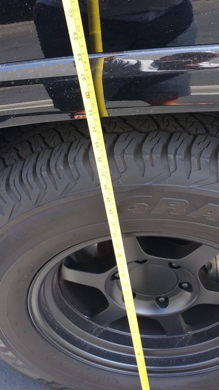

Exactly. You want to measure hub center to bottom of fender. Much more accurate way to measure. Front hub center to bottom of the fender is 19.5-20 inches on stock SR5 suspension.
front = 34.5"
rear = 36"
But this is on my Trail w/ KDSS
Front
Rear
