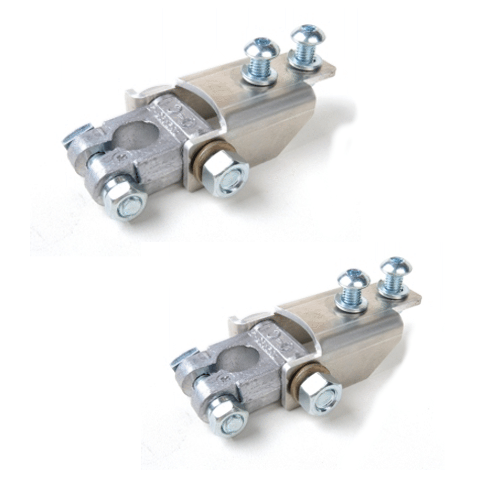

I have seen many people put in Group 31 batteries with a variety of methods of extending the factory cable to the battery posts. Some, in my opinion are questionable yet creative, some interesting. I have a friend that has a 200 Series that sent me a pic of extenders he got with a Slee kit, and they appear to be the same situation as a 5th Gen. On Slee's site, there are not listed as an individual piece, but are included with the kit. Slee can sell them as a seperate item at a fair price. Just ordered a set today.
I will post up when installed.

So, do you have pics of this? Slee Off Road now sells these completely separate for $50... I'm interested in your experience with them...
Battery Terminals and extensions - Slee Off Road
I have a group 31 odyssey battery and the cables don't reach. I would be interested to see if the slee or SDHQ extensions would be long enough.

I do not believe I have any pictures of them. Totally worth it and easy to install. In, I believe, the positive cable, I had to bend the 90° tab to flatten it with a pair of plyers. I am looking to get them again when I upgrade the battery in my Tundra

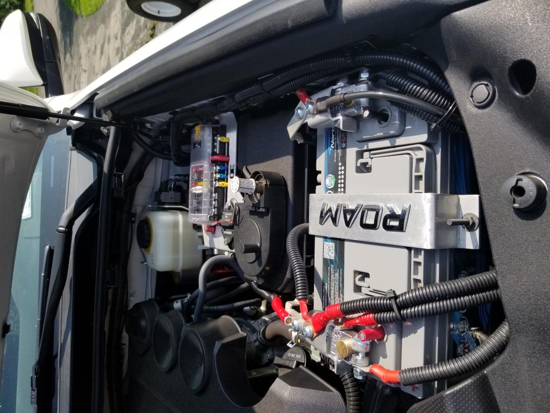

so i installed the slee extensions with a odyssey group 31 today. The extensions are worth it. It makes the drop in plug and play. I would have saved money by buying the slee in the first place, vs. buying connectors, wires, terminals, shrink tape, and tape.
The slee also gives you alot of adjustability (angles) and allows you to add as many accessories as you want without disconnecting the battery. It's also rock solid once tightened down.
its well designed and worth its price.
