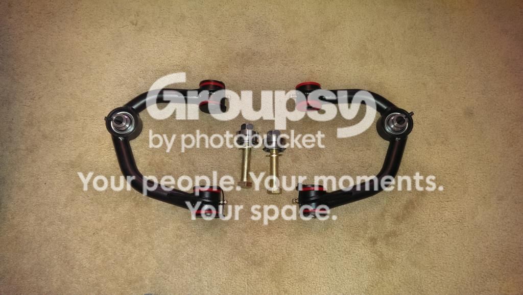

Came yesterday
IMAG0414_zps0ajryjqi.jpg~original

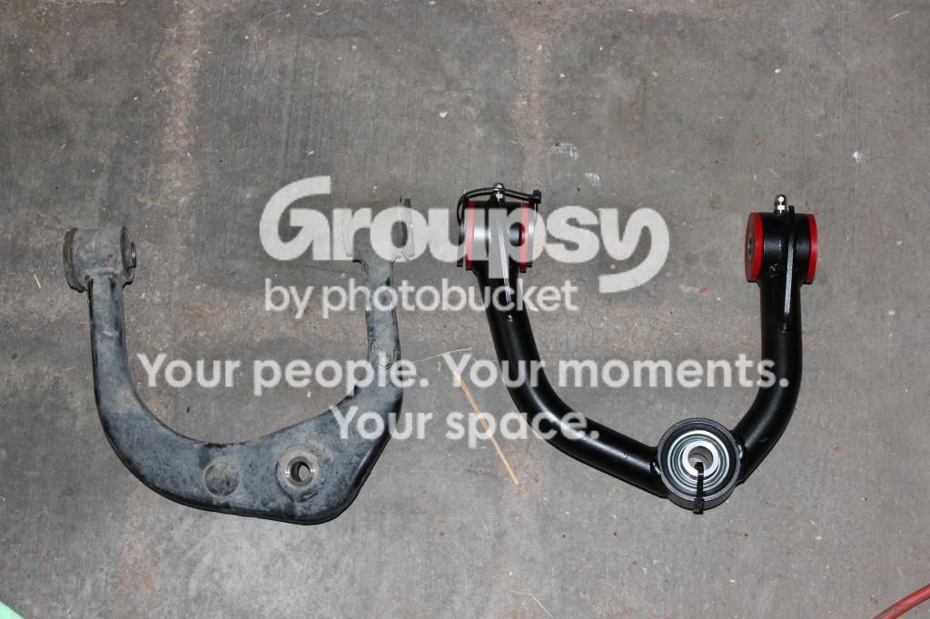

Old vs. New
IMG_86581_zps31b88df0.jpg~original

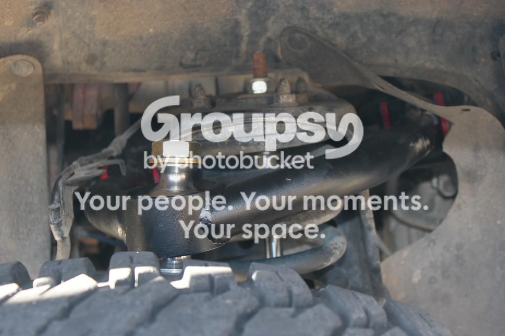

Drivers side done
IMG_86591_zps0806be54.jpg~original

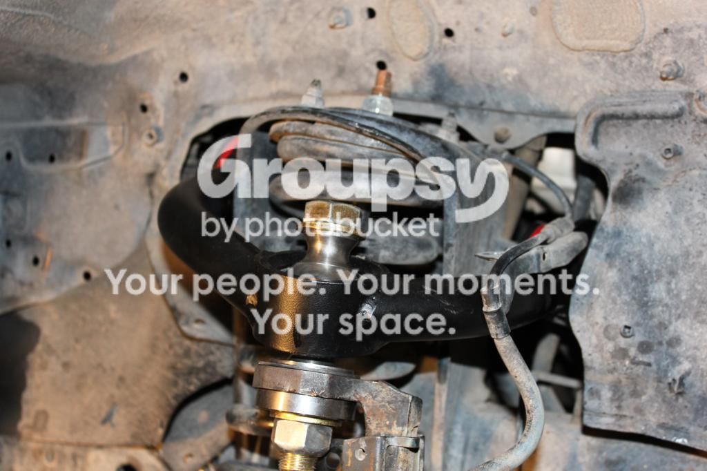

Passenger side done
IMG_86741_zps937c051a.jpg~original

After changing out the UCA's there are no more clunks, squeaks, or play in the front suspension. That feels soooooo good.
Only one bone headed mistake on the install. I've never done upper ball joints on any vehicle before and I tried to press the first one out before removing the retaining clip. After breaking my 3 jaw puller, fixing it, then removing the clip (which is much easier if you don't bent it into place by trying to press it out) everything went pretty well.
Took it Friday to get aligned and I've got almost 3 degrees of caster on each side. Never seen that before.
