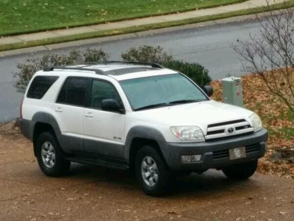

Here it is, from the CL ad.:
A turd right? Haha, well I knew I didn't like them stock anyway. Plus I knew I would be modding it soon anyway.

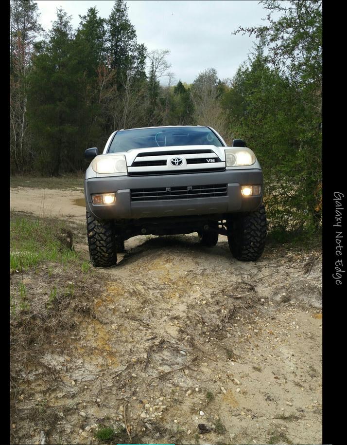

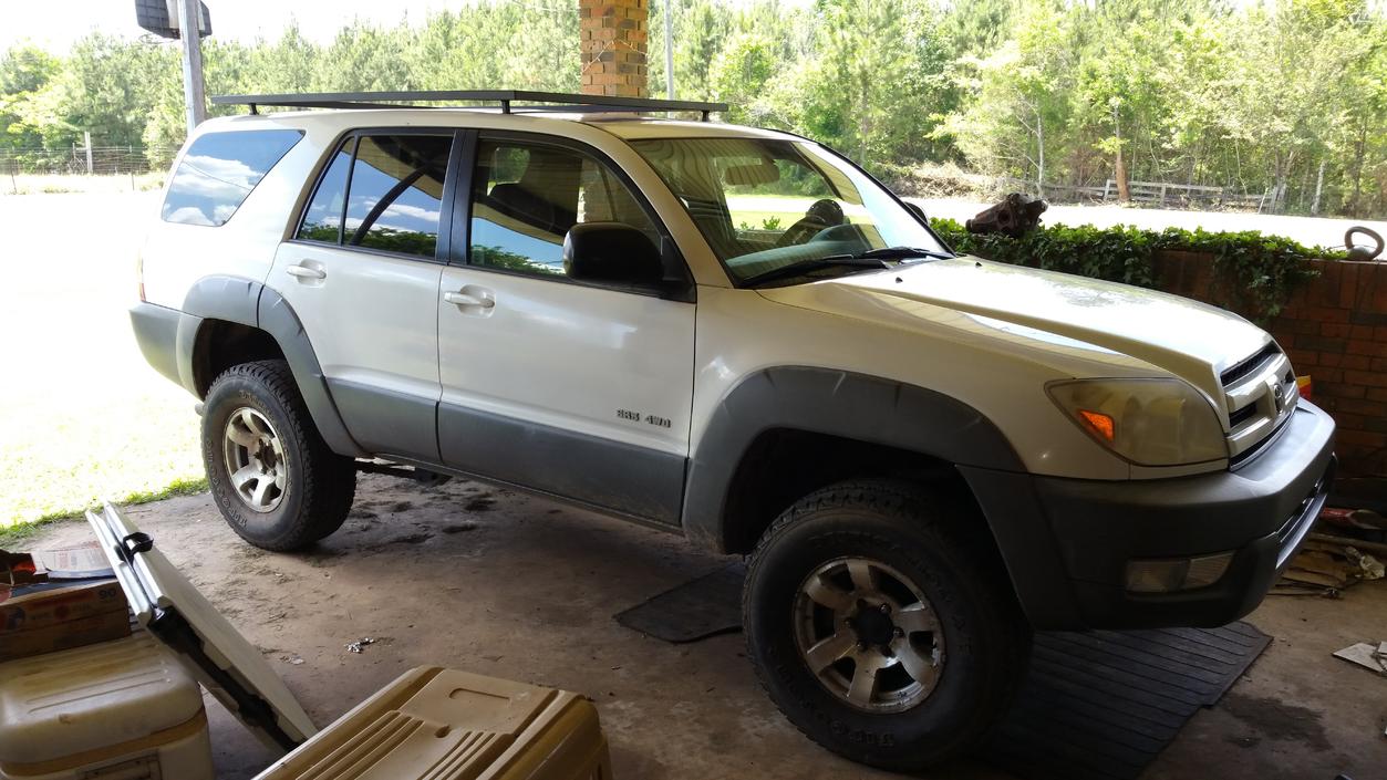

Here we go. My first mod... factory steps came off. I give this a 9/10 on mechanical skill requirement.

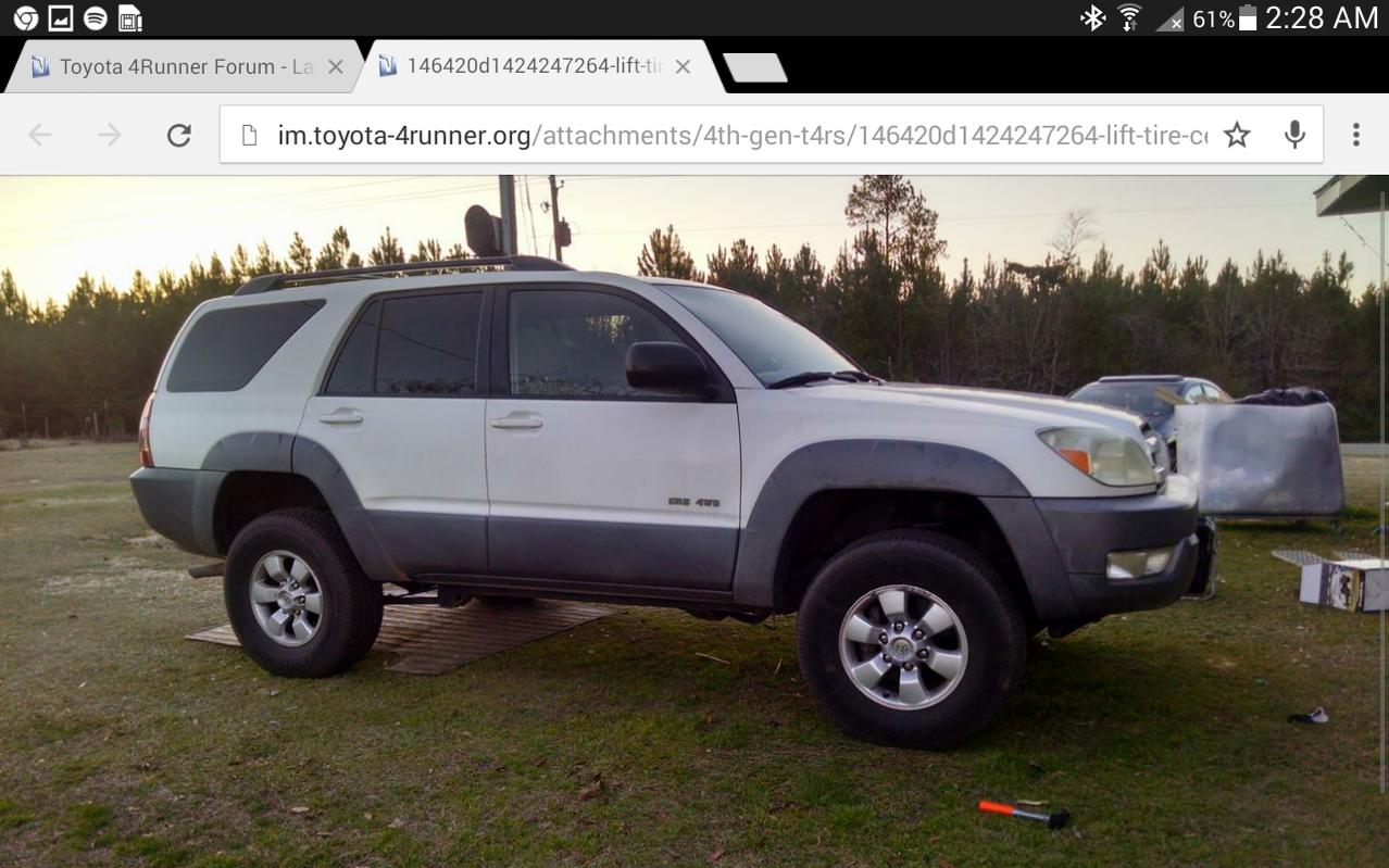

Daystar lift- about 3 weeks after bringing it home
(~4 hour job by myself) :
Ugly, beat up wheels that worked great for my 285s
Immediately following the lift.
The 285s were out of round, so I sold them to a guy with a mud truck. I put a used set of Firestone on temporarily.
I also started fabbing a roof rack. The frame is done. Just need to finish it.

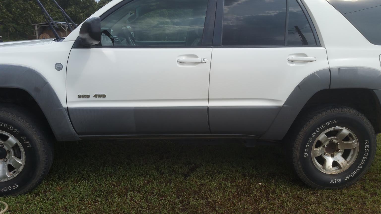

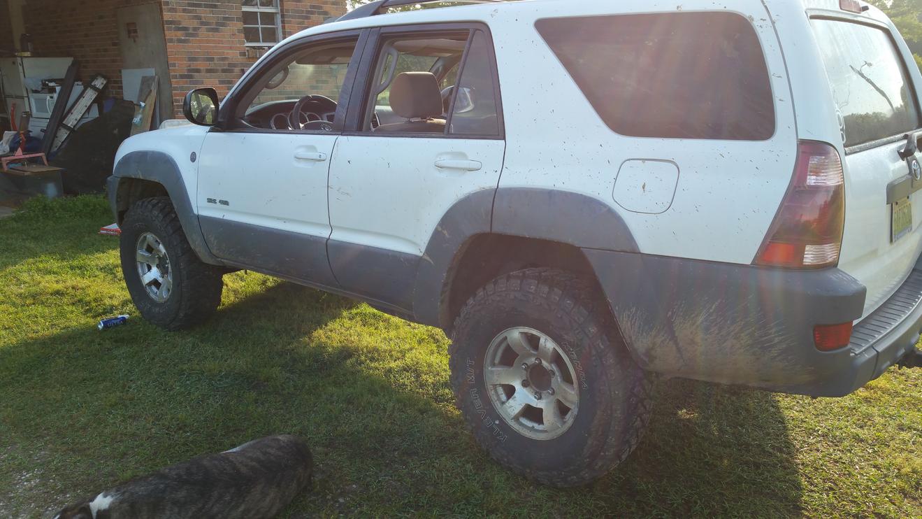

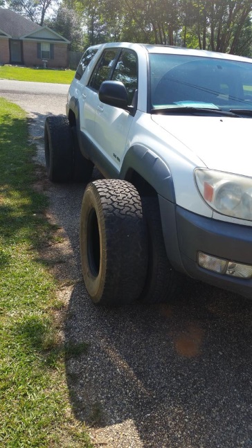

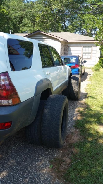

Okay guys, here are some randoms:
285-75r16s:

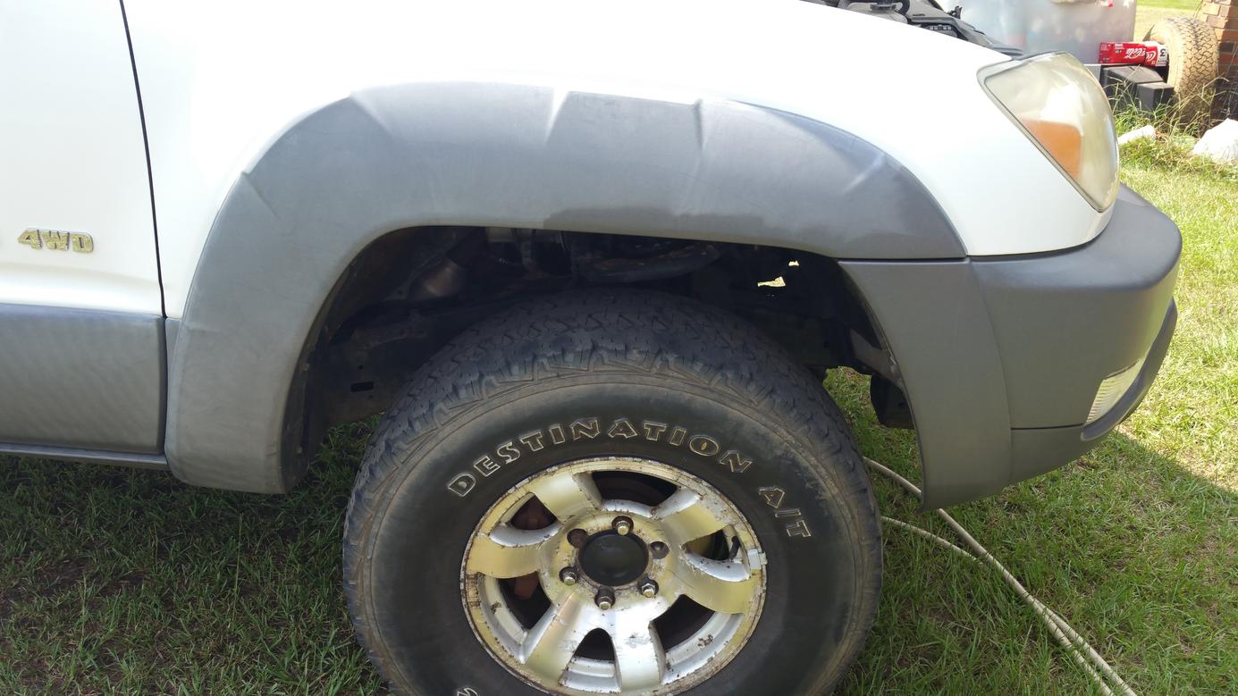

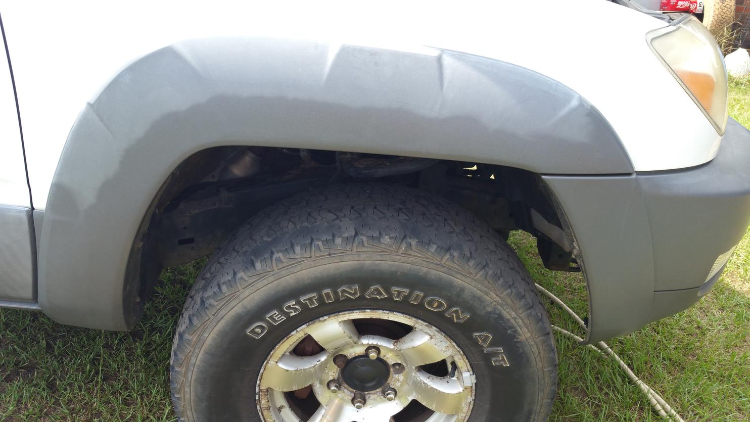

So for all of you with cladding, I was able to get mine nice again with a heat gun. There are plenty of YouTube tutorials, and info on the internet, but just ask if you have questions.
Before:
After:
During:

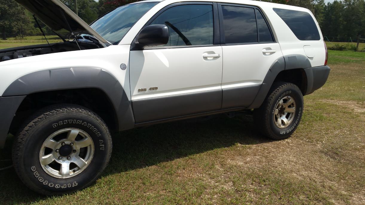

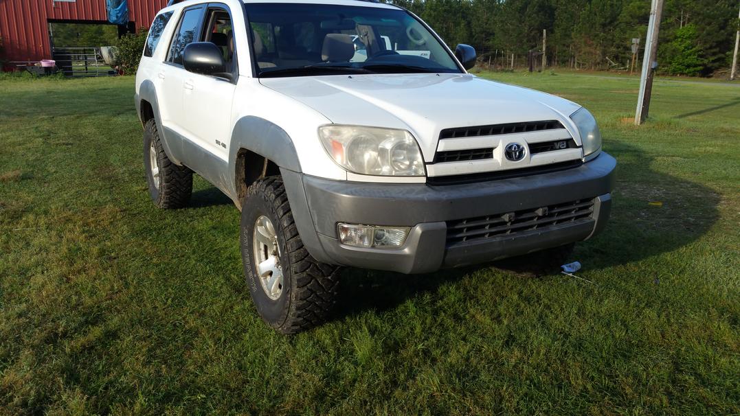

--Bought- early February 2015
-- oil change days after purchase (forgot exact milage ~145k; Valvoline full synthetic)
-- Lift bought Feb 6, 2015 (installed days after)
-- alignment attempted (immediately following lift)
-- Energy suspension control arm bushings, and alignment hardware replaced (~Feb 18, 2015)
-- alignment done (~Feb 25,2015)
-- Oil change (forgot date, 4,9xx miles according to trip B; full synthetic valvoline)
-- Cladding refreshed (Oct. 3, 2015)

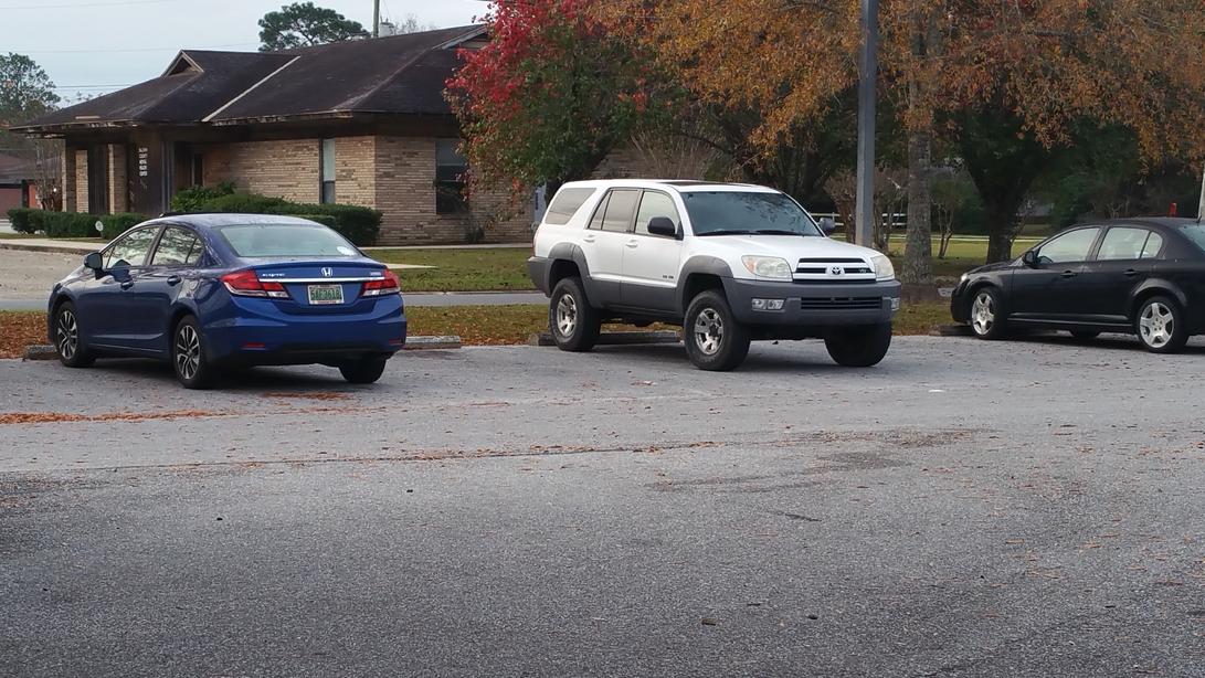

CURRENT STATUS :
(Dec. 1, 2015) my wife's blue Honda as well
SUSPENSION
--Daystar lift
-- energy suspension poly bushings in control arms
-- stock everything else for now
WHEELS AND TIRES
-- 265-75r16 Firestone at
--factory 2002 toyota 16x7 wheels 4.5" backspacing
PERFORMANCE
-- Flowmaster muffler
-- Clean stock filter
"STUFF"
-- weathertech mats
-- Kenwood radio
-- homemade roof rack (in progress)

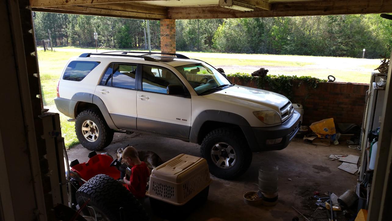

Well... 15" wheels WILL go on the truck. It will take a whopping 2" of backspacing to make them fit though.
I tried bolting them up with the 1.25" Spidertrax, and they would only clear if I ground down the caliper. So naturally, I did. I ground until I got nervous. I managed to get it to the point where I could snug the lug nuts down all the way with my fingers, and the wheel wouldn't scrub. However; When I snugged the lug nuts does with the pull bar, it forced the wheels onto the caliper by about .02", and froze the wheel.
I think the wheels I have are 15x8 and -25 offset (roughly 3.5 backspacing). I will be in the body mount and the bumper (and everything else) very heavily if I can make them clear.
At this point, it's more about providing info for whoever would like to know. Truthfully, I'm not sure if I want to run that little backspacing. I may, and I may not. It depends how the end result looks, and works.
Alright. Off to buy more spacers.

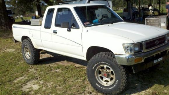

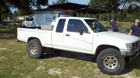

Found a couple of old photos of my old truck.
1994 toy pickup
22RE
4:88 gears.
Lightly tubbed firewall
No lift
33x10.50 15
This was right after I rebuilt the engine the last time, and installed the 4:88s. (I had stock gears, and 4:56s before I went with 4:88s)

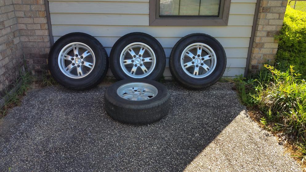

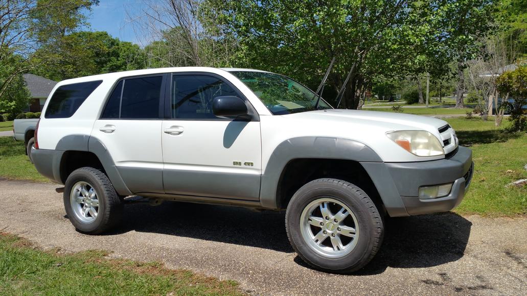

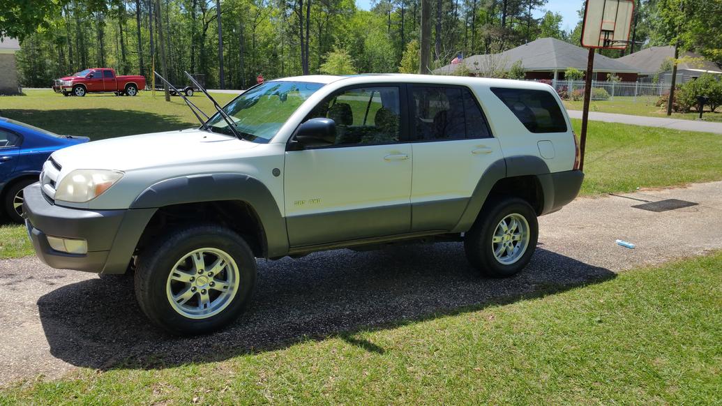

Scored a set of FJ cruiser bbs wheels and tires today.
4.5 backspacing.
17x8
255-65r17 street tires (very temporary)
Also did an oil change

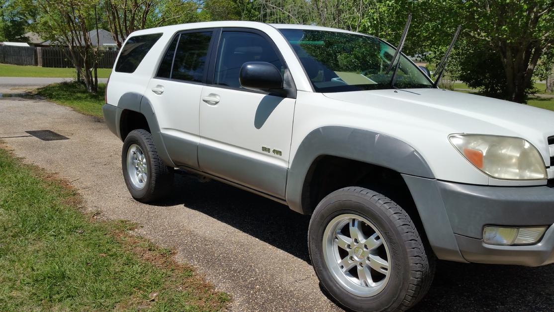

Got the wheels on last night. Also gave the truck a quick wash today.
Need mo tires!! Haha. They ride good though.

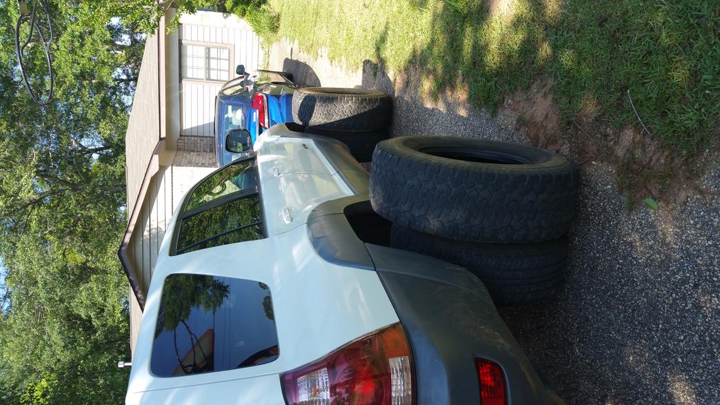

I had a thought cross my mind
Damnit. Why are they sideways?
