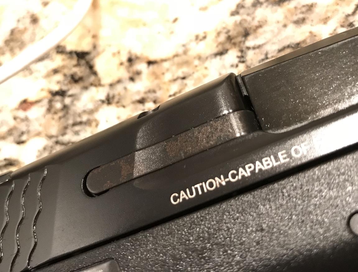

Today I pulled out my S&W M&P Shield 9mm to do some shooting with the family. This was my first time pulling it out in a while, and found some slight rust/pitting on the thin bar behind the chamber (not sure what this piece is called). Also had some light rust in the serial number, but it mostly rubbed off while cleaning.
I gave it a good cleaning/oiling the last time I shot it, but I made the mistake of letting it sit so long without rubbing it down again. Do I have any options for cleaning off this rust? Never had to deal with it on a firearm before. I’ve seen online that some people gently use #0000 steel wool and lube, but steel wool always scares me on anything with a finish.

That's your extractor. Try lightly rubbing with steel wool dipped in oil, don't use much pressure. If you're unsure about damaging the finish place some masking tape to protect the slide first. If you clean off too much finish, slap some cold bluing on and forget about it.
Alternately, find a gunsmith. The extractor can easily and cheaply be replaced.

oooo SS wool with gun oil and pencil graphite are both good methods. I'd start with the graphite and then move on to the wool/oil if needed.
That's not much rust, just on the surface and with small pitting is what it looks like from the photo. I'd remove the extractor to check everything underneath for rust also. Heck I'd fully disassemble the gun and give her a good inspection.

Keep in mind when dealng with rust where it is the worst the bluing is more
than likely toast. Use your method of choice to remove or kill it. To spot dress damaged bluing Birchwood/Casey's Presto Gun Blue Pen works well, Oxpho-Blue from Brownells works very well. With what you have no big deal
