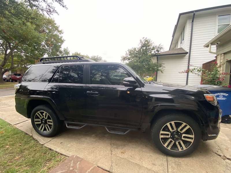

I've got a 2017 T4R LE with shot (or at least leaking) shocks that need to be replaced. I've wanted to do a level or lift for a while, so now faced with $1750 in parts alone to replace OEM shocks, now seems like the time. Would appreciate feedback on my plan.
This is a daily driver with very occasional dirt roads and trails, 99% pavement and occasionally packed up heavy for a road trip. Looking for a comfortable ride with a little bit of a fun look. No major mods or additions planned after this.
Planning to pull out XREAS and put in a Bilstein 5100 kit with OME coils (2885 front, 2898 rear) with SPC upper control arms. The goal is a 2-2.5" front lift with ~1.5" rear lift. I can get all this done (parts plus labor) for under $1700. Am I missing anything? I don't think I need to replace XREAS with anything, right?
If I do this, I'll end up with a lift on the stock 20" wheels, and I plan to swap those for 17s. A problem for another day.
XREAS is a full system, so you have to replace it all at once, which you already know. Apart from that, there is nothing else to know about XREAS, either it is on your rig or it's not.
As for the lift you're wanting to build, it sounds right but I am not familiar enough to weigh in, but eager to see what your thoughts are after you install. My XREAS needs replacement and I am doing something similar, but I want minimal lift so I am not changing as much as you plan to swap.
those springs are meant for significant weight at all times. rear is 3" lift with 400 lbs extra and front is 3" with 150 lbs extra weight. I think that is way too much spring for your intended use on a daily basis. with no bumpers or heavy mods.
Oh, that's interesting. I'll admit I don't understand adjustment possibilities/notches and all that that determine lift height... There are really only 3 options for each, and these are the "medium" coils. My lift guy suggested these, but I'm not sure why.
You're saying using these coils would result in a rough ride, or that the lift would be taller than I want, or both?

There are MANY other OME spring options other than these. Look at wheelersoffroad and look at all the OME springs for front/rear. Tehy list specs specific to 5th gen 4runner. with those springs you want and no weight you will be bouncing all over the place. they are basically meant for rigs with steel bumpers, winches and full gear in the back.
Old Man Emu 4RUNNER Heavy Load Coil Springs, 440 lbs Constant Load (2898)
from their specs tab:
4RUNNER 2010+:
2010+ 4Runners carrying approx 400lbs+ of extra weight at all times, provides approximately 3" lift when loaded
Toyota Tacoma Old Man Emu Coil Spring, Stock/Light Load Spring (0-110lbs) 1.75" Lift OME2885
2010+ 4Runner 4WD (stock with 70-180lbs bull-bar and winch) - Approximately 3" Lift
4RUNNER 2010+:
Super helpful - thank you! Looking at Wheeler's it looks like I should go with 2884 in front and .....2889s in the back? That sound right?
