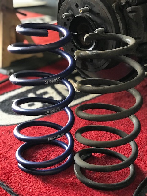

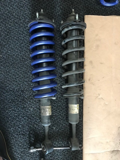

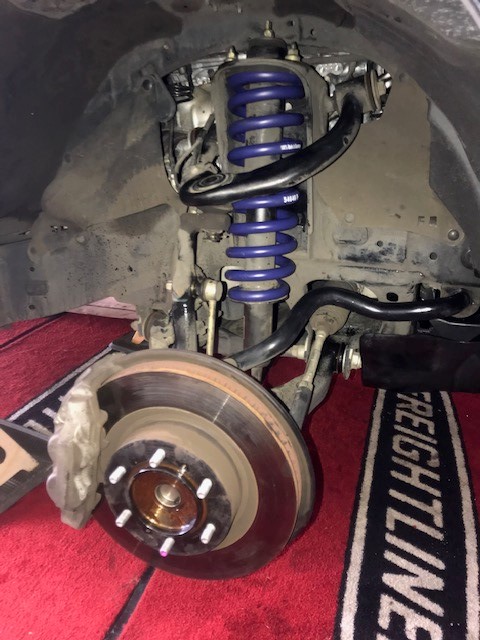

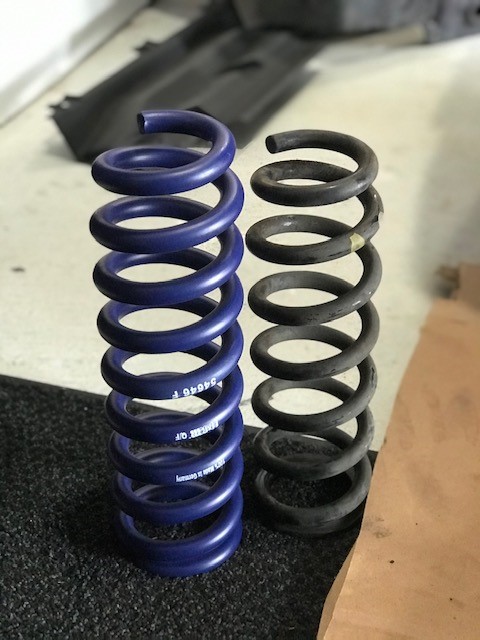

I'm late to the party but I have been running them for 10k miles now and very pleased. I have 2wd/3rd row model and the front was a little high. gained 2.5" in front after break-in and 1.5" in rear. later I added 1.5" daystar spacer on the rear and 2-3" fox 2.0. I will be adding the front Fox strut w/adjustable spring seat. The ride is stable and responsive but also forgiving when pushing it. It is comfortable to drive, not jarring like tundra springs on a 3rd gen.
