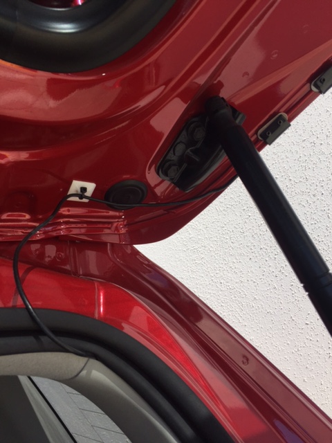

So I have my coax routed through one of the grommets in the upper part of the rear hatch. Just poke a hole and route it through then put something there to seal it up again. Then it routes down the rear pillar and under my tool box to my brain.

I have 2 CP5's , one on either side of the hatch, feeding Kenwood D710 under the driver seat, and a V71A under the passenger seat. Like others, I ran the thin lead in through a slit in the grommet, down through the pillar, under the back trim and along the door sills. The 16ft length was just enough to get under the front seat with not much to spare. I don't think you will make the glovebox with the supplied cable.

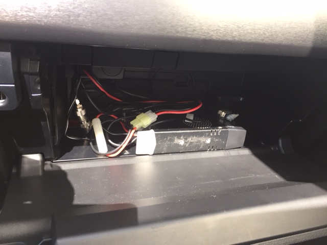

i did the install last weekend. Used a CP5, mounted in the upper right of the hatch, routed the cable direct across the rear door seal, into the side panel plastics inside right where it meets the headliner in the corner, and then along the black side panel (above the cubby area in the back passenger side), down the kick panels past the rear and front passenger seats, up under the glove box and into the glove box. Just enough to get about 5" into the glove box, and from there used some right angle connectors and a thin 1.5 ft cable to connect to the radio in the glove box (used that to prevent cable binding and harsh angles)

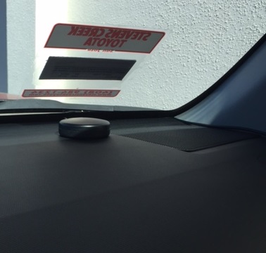

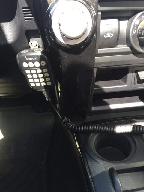

I used the popout in the glove box to run all the cables. Speaker is down installed in the front right passenger kick panel, mic run along the center console, and I will be putting a GPX 18x puck on the dash and running the cable down the side.

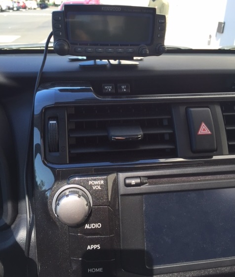

D700 remote face mounted front and center on the top of the dash. Quite nice in the end.
