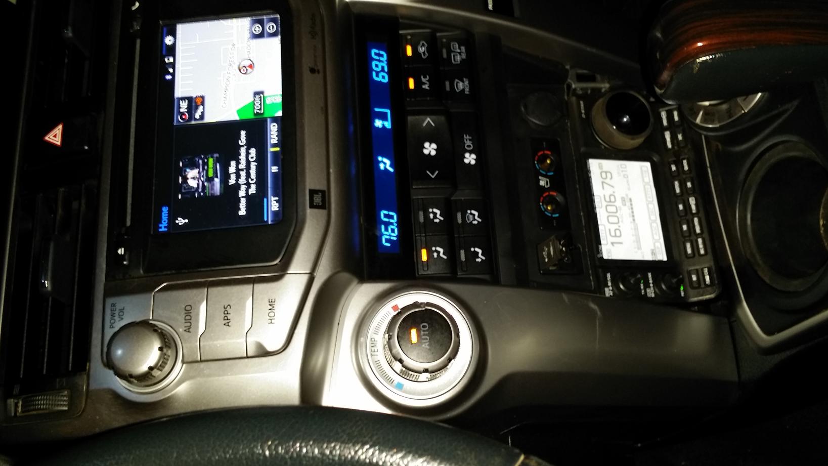

I don't know.....I mounted my ICOM in my Unlimited and I am pretty pleased with the outcome

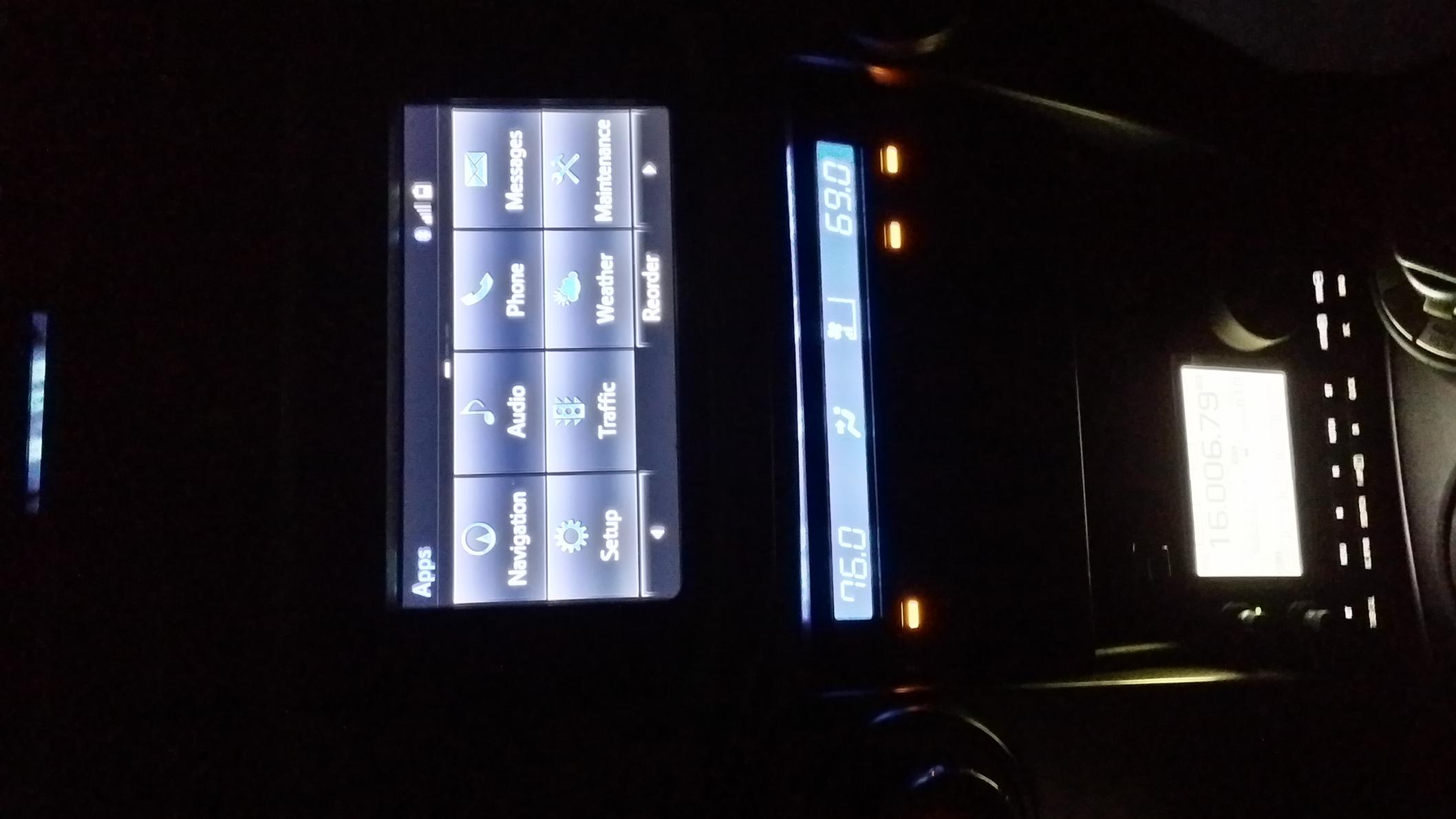

Mr Dremel got quite a work out and I still have a few adjustments, but pretty happy with the (semi) final results

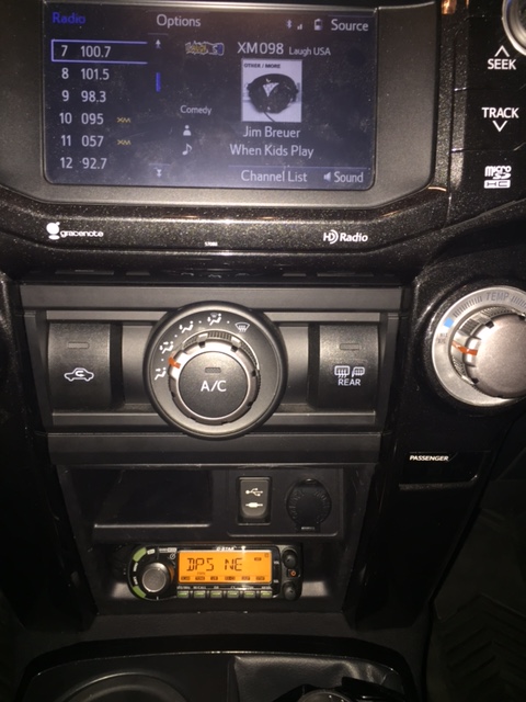

Has anyone found a convenient way to mount a ham radio in their 4runner? Thanks for any ideas.

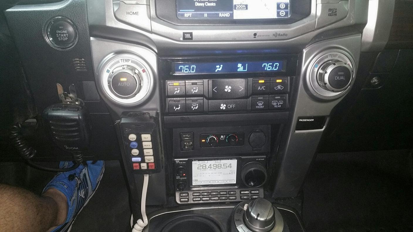

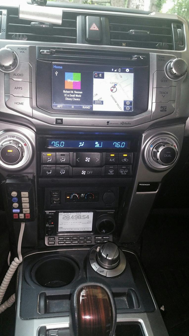

I have an ICOM- IC 7100...I mounted it in the blank spot below the A/C

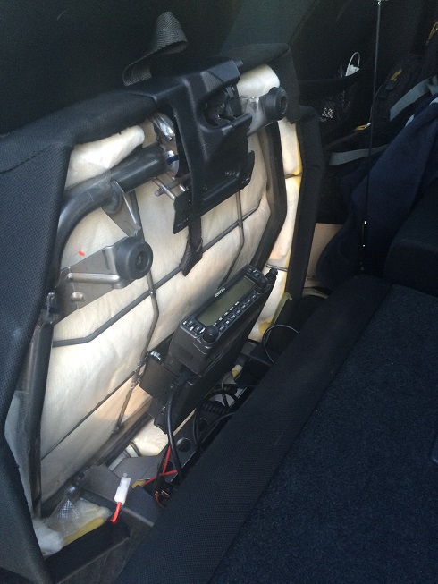

I'm mounting mine under the rear seat which has a ton of space if you remove the pretty liner and using thumbscrews. I'm using cat 6 extenders to run the cables up to the front. I can remove everything whenever and bring it inside to my desk/safety.
Also with the seat flipped up I can use it while sitting in the rear or with the seats laid down while resting in the back. I haven't decided how I want to run the sound up to the front.

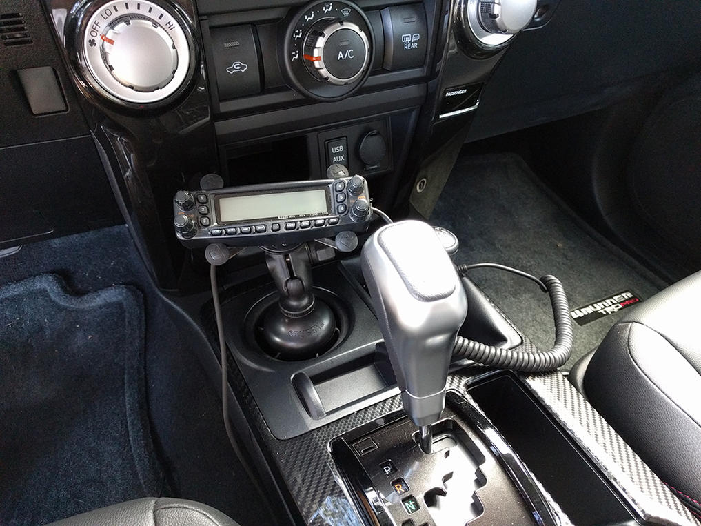

I used a Ram Mount Cup Holder Base and X-Grip for my Yaesu headmount. Wanted something that would be easy to remove as I only really use the HAM when camping or out on the trails.
