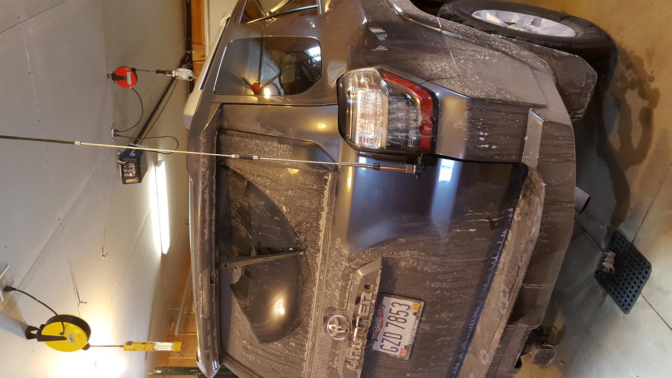

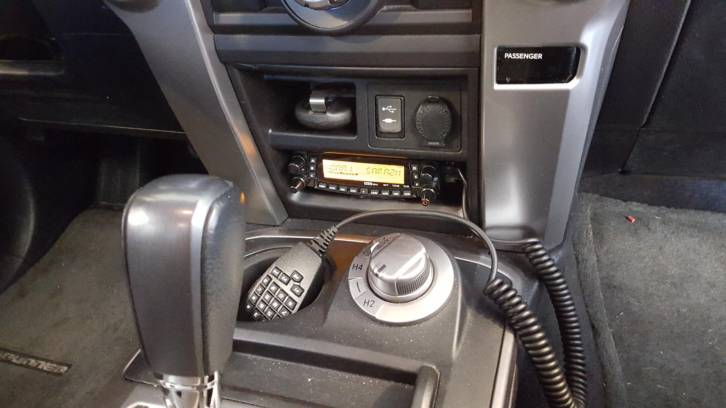

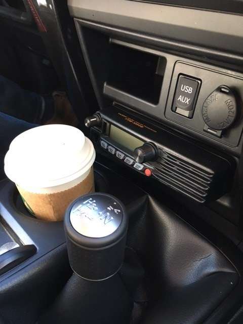

I used velcro to attach the main unit to the carpet under the front passenger seat. The attached the face plate to the cubby hole with velcro. Ran power directly to the battery. Radio is THT TH-9800, antenna HH-9000, on a Diamond K-400 trunk mount.

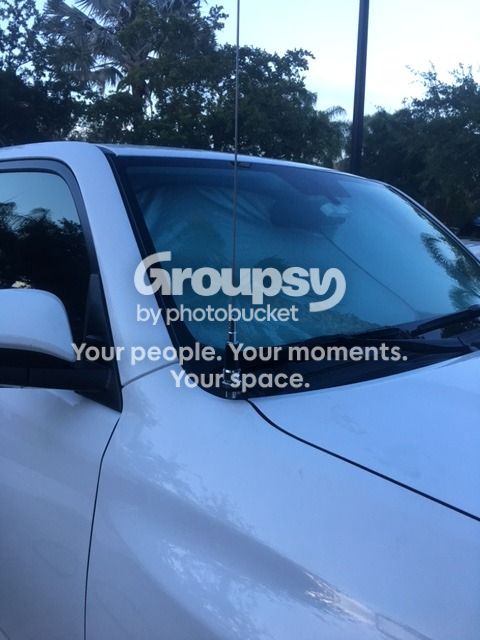

I Just started working on my HAM set up. Here's how the antenna came out, will be tackling the radio this weekend.

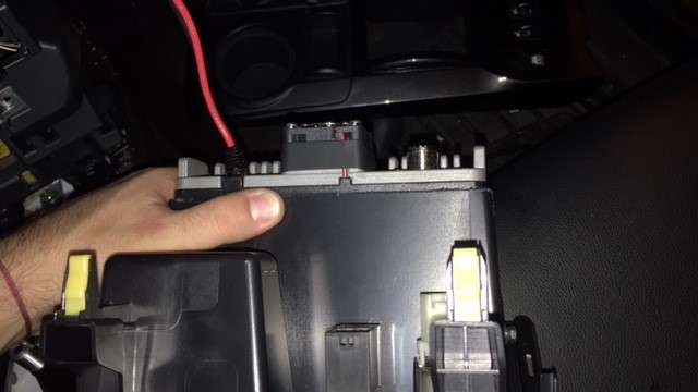

Very clean job, did you have to cut a lot out for that to fit? Looking at the same radio for my truck.

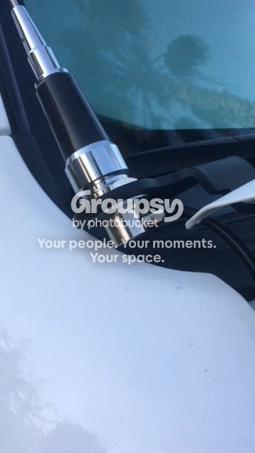

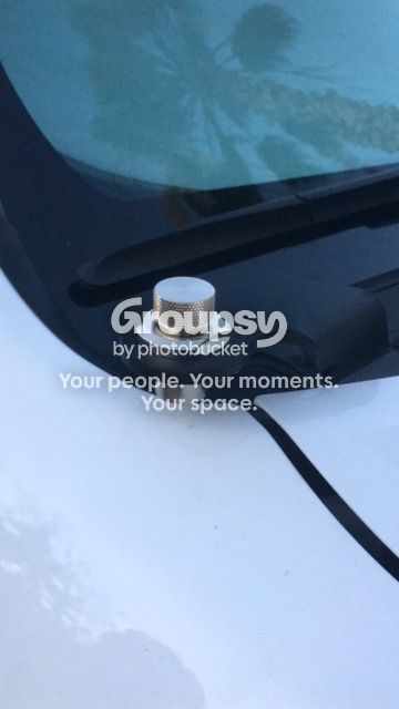

You'll need to fully cut the back of the pocket. It's tight as the A/C tunnel for the back seats is routed right behind that. Here are a few pictures, I used a heat gun to melt the A/C duct and had to trim a portion to make the antenna connection fit in. I could have maybe cut A LOT and made it more flush but didn't want to kill the air flow to the back. [MENTION=134477]Toyojay[/MENTION]

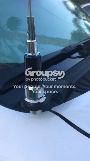

I also picked up this antenna on eBay, I wanted something small and stealthy. I know its not the best but I've used it almost all day, NOA Weather and simplex without a problem. I guess for $15.96 cant really beat that...

Even not being flush, it still looks great. I might be concerned with heat from the unit back there.
I haven't seen an antenna like that before, what kind of range can you get out of that? I'm assuming fairly flat ground there in FL?

Which mount is that? Can you snap a side shot with the hood open? Also, did you have to cut or melt the plastic inside the engine compartment?
Wow that is a 2 meter antenna! I see the 136-174 mhz but I wouldn't have believed it if I had not have seen it. Can you please post a link to that antenna and mount? I may have to get one for my 2400 or 7800. 73

Thanks..! the YAESU FTM-3200DR has a small heat-sink fan in the back, that was one of the reasons I picked this unit. Florida is very flat, I'm not sure what the rage is, but it's worked so far with "0" problems.
Thanks, I really don't know a lot about HAM. Just reading around and studying for the license test. I just kept looking till I found one with similar specs to my Dimond M285s. The mount is a CBI and you can get it on the passenger side or the drivers side. Most use these for lights, you'll need to open up the whole a bit to make it work.
Here's the link for the antenna.
US Dual Band Gain Antenna Male For Car Mobile Radio UHF VHF 400-470 136-174MHZ | eBay
Here's the link for the mount.
5th Gen Antenna Bracket | CBI Offroad Fab
what is the gain on that? i can see it working on 70cm but not 2m
I'm not 100% sure, looks like it does based on the specs but I'm still learing so don't know if it does or not.
