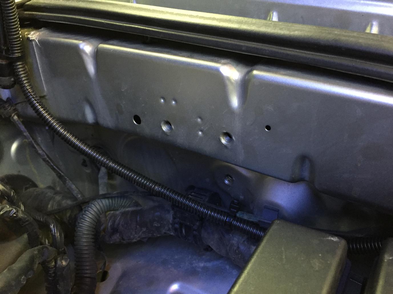

I've got three LED light systems (driving, fog & reverse) and I may add a LED bar in the future. I've been looking for a way to mount them all in the open spot between the battery and the firewall. I've not had any luck finding an off the shelf solution & was wondering how you all solved for this?

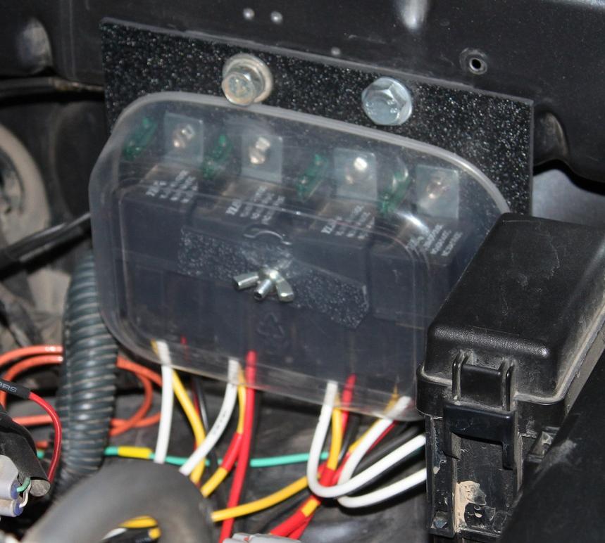

I did the ghetto version.
Piece of ABS plastic a couple $8 30amp fused relays and a plastic container lunch meat came in for a dust cover...lol.
