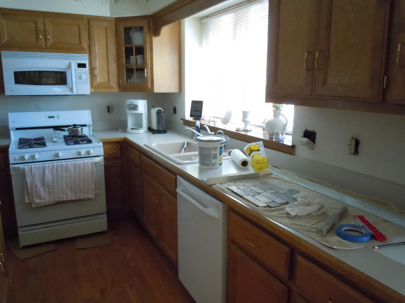

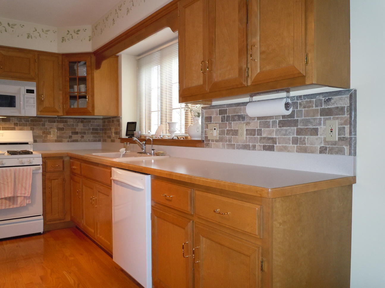

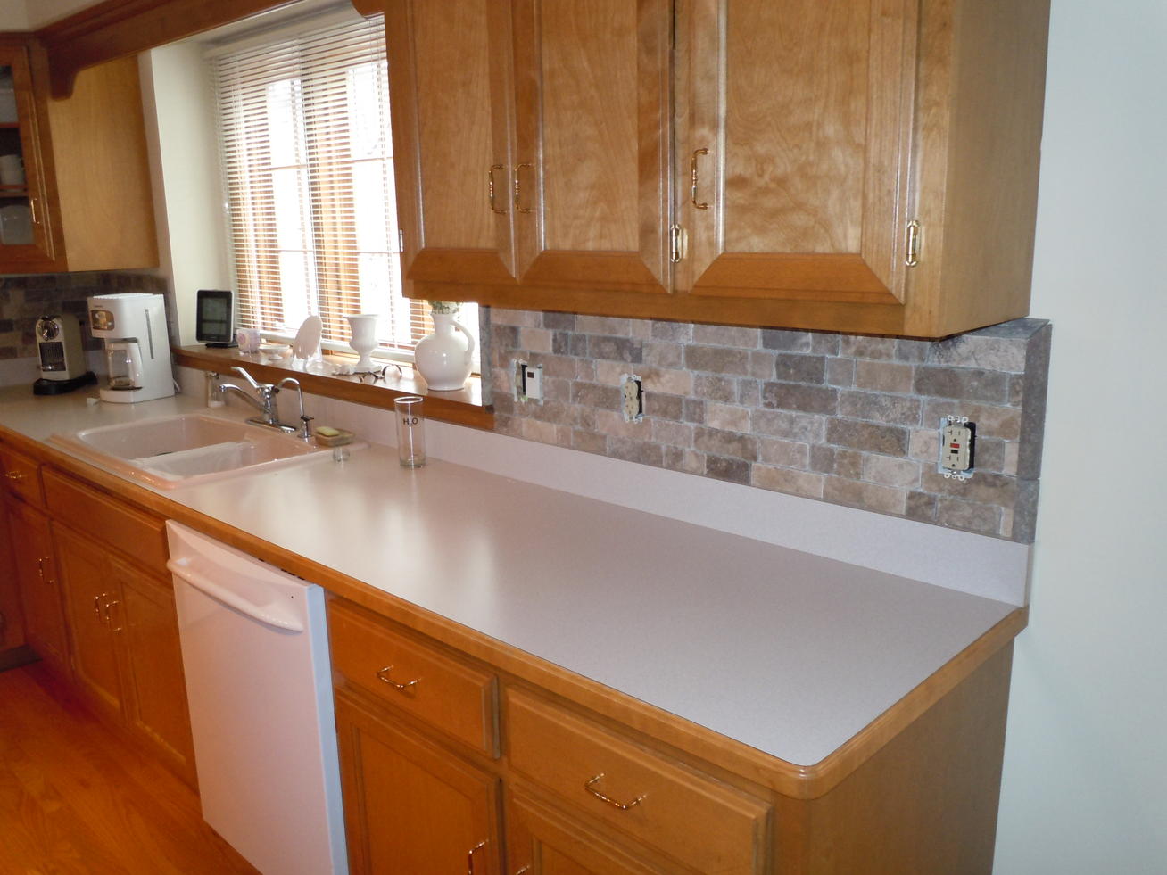

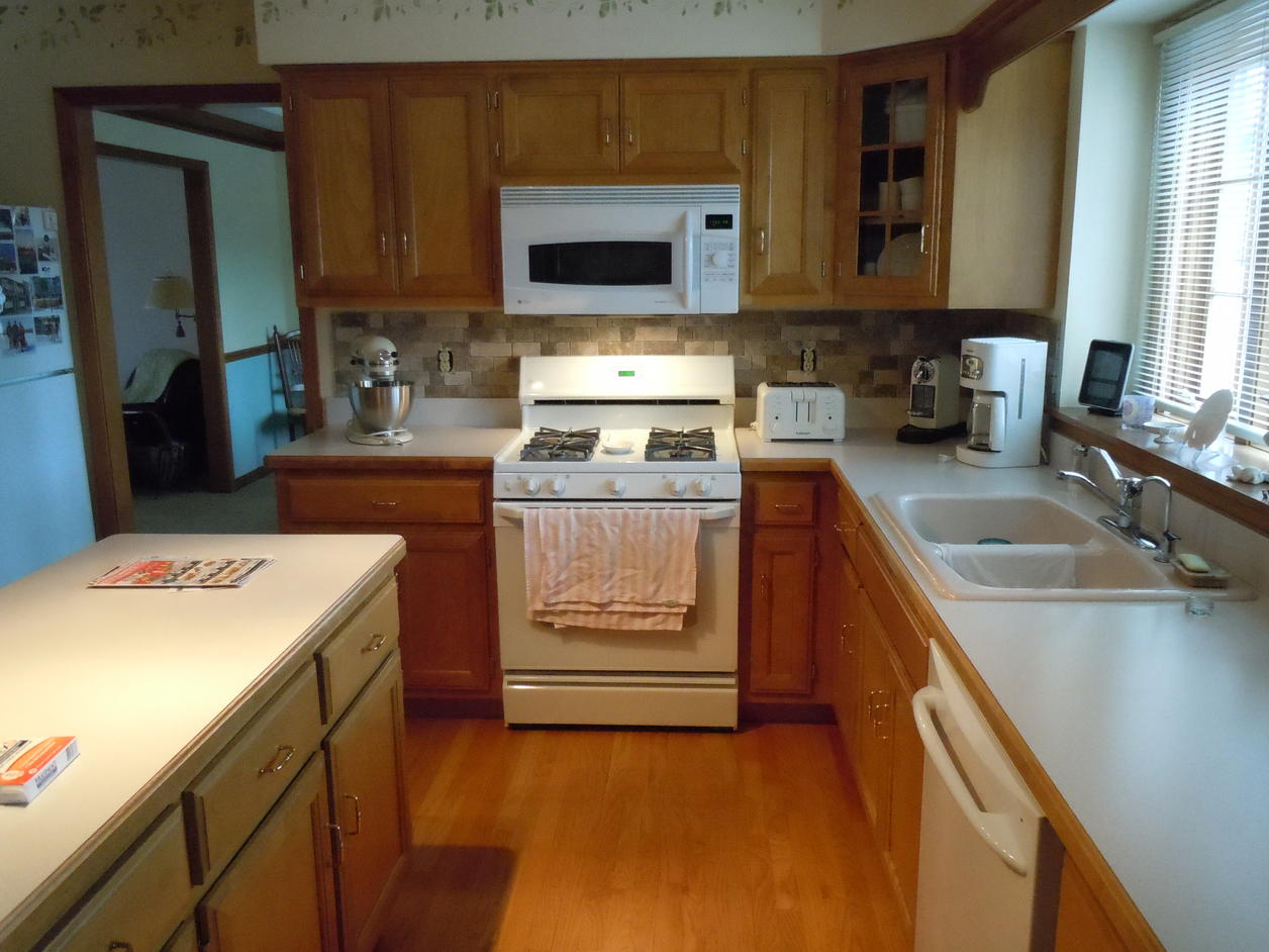

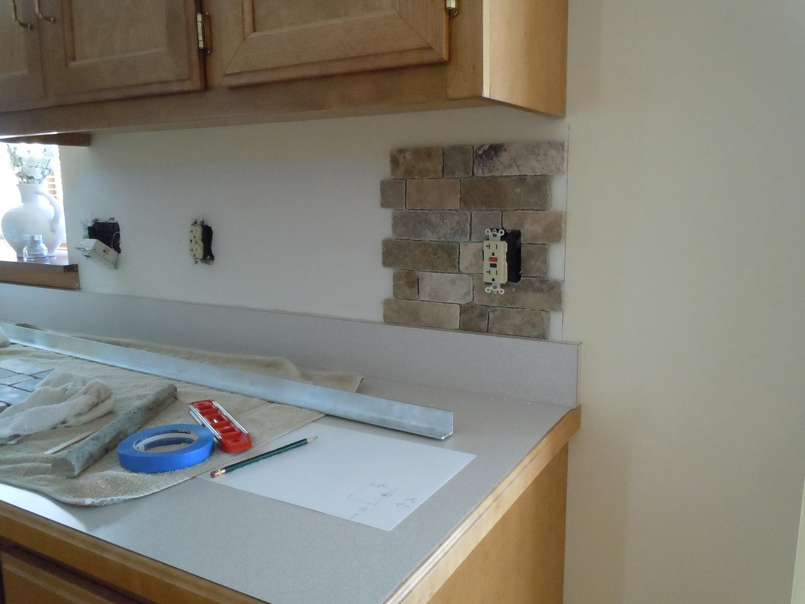

Here's some shots of my kitchen tile backsplash project. Keep in mind I had to remove old boring tile, mud smooth and start with basically fresh walls.

that looks awesome! gives me ideas to do mine. I really want to put the glass tile in.
