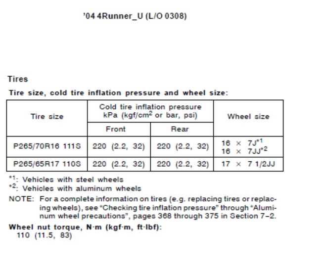

I think it is probably more correct to follow michelin guidelines than toyota at this point. But Toyota manual says minimum cold 32.
the only guidelines from michelin is the max psi rating of 44psi & that should really never be used for any normal driving & will make the tire wear very unevenly. stick with toyotas recommendation for any normal tire, you can play with the psi a bit if you want to improve the ride some but lower psi hurts mpg & higher hurts tire wear.

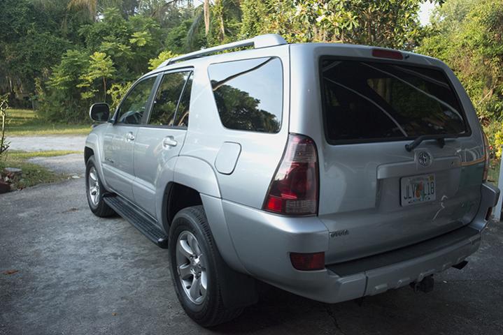

Old picture with duelers on. P.S. Damn those michelins have a lot of tread on them !!!
