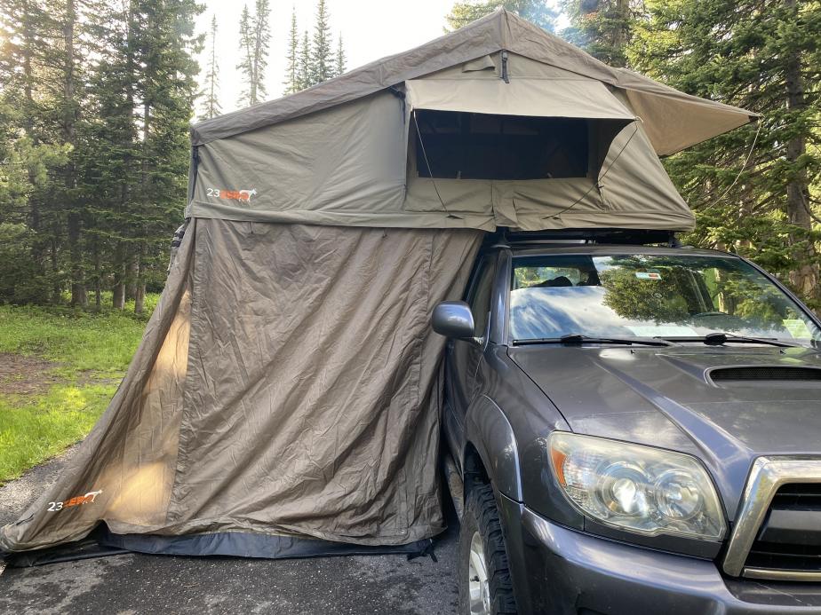

Awning is something to consider. My wife gets up in the night to use the loo, so likes to sleep on a cot down below. Works great. Picture is Yellowstone NP. We were on a paved spot, so couldn’t tie down corner. Otherwise is a little less wrinkled.

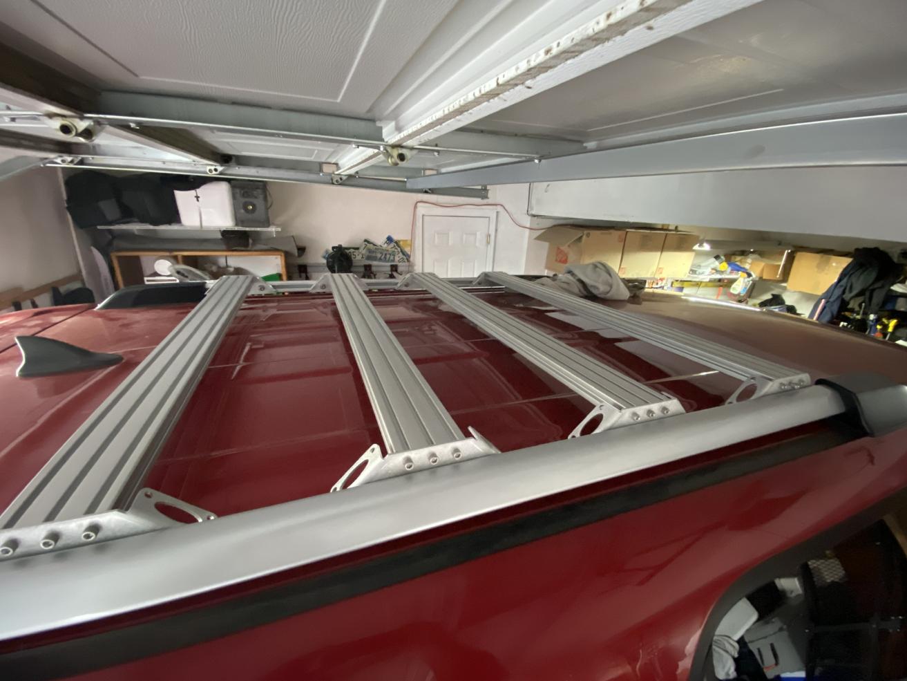

Been my understanding that a hard shell RTT can be mounted to stock roof rAck with addition of stronger crossbars like LFD, has anyone done this and care to post up a pic?
Try the Niserack. Installed on factory side rails, super solid. Less than $300.

Would it be long enough to install a hard shell RTT on it? Thinking something like the roof nest.
I put the front and rear mounts as far apart as possible, and then measured the distance from the back of the rear mount to the front of the front mount (maximum surface distance). I got just over 38 inches. This is definitely not a full roof, or even a 3/4 rack, so you would have to measure the mounting requirement for your RTT.
My 23zero has a distance between mounting rails of about 33 inches, but I mount mine sideways (ladder and entrance on passenger side), so it fits with no problem.
Hope this helps. Let me know if you want some pictures with tape measure or items on top.
