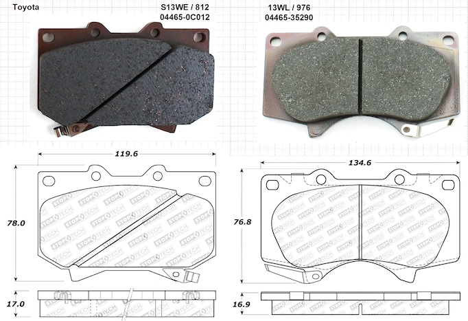

It's time for a brake job, and I've been considering the 13WL/231. Fifteen years ago I upgraded to the S13WE/199, but a recent trip across the Sierra Mtns brought back the judder, so wondered if maybe the 13WL will help.
It sure seems the pad contact areas are about the same. Are the 13WLs really better than S13WEs? I pulled the pad images from Toyota dealer, and the drawings from StopTech. I scaled as best I could so HxW is accurate (thickness is off).
I wish the 13WL pads filled the back plate.

Here's another thread comparing pad sizes: TBU 231mm vs. 199mm Pad Size
I don't think one has an advantage over the other as the brake pad contact surface is roughly the same size, both calipers use the same size pistons, and both calipers use the same thicker rotor. Some people say the S13WE calipers have better clearance when it comes to aftermarket wheels but I can't speak to that.
