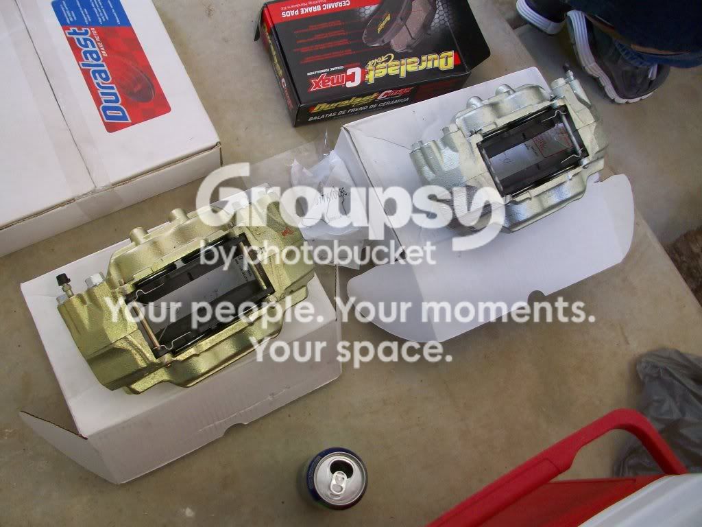

I initially went w/the NAPA stuff because it was readily available, the calipers are warrantied (versus getting them from a junkyard, you take your chances), and others have had good luck w/the NAPA setup. My only concern was that the NAPA rotors seem to be poorly cast and may have some balance issues. OEM Replacement Brembos are available on Amazon for about $64 and you can move up to a PowerSlot for about $120. Also, NAPA lists two different grades of Rotors.. there's the one I got, and a Premium which costs $90. That's the same as OEM, so why not go with an OEM rotor?
Upon further consideration, I have returned the NAPA Brake Rotors & Brake Pads due to quality/performance concerns. The NAPA Rotors went back because they have a lot of casting irregularities. The NAPA pads are not only MORE EXPENSIVE than OEM pads, but the pad surface has a chamfered edge that reduces the surface area of the pad that actually contacts the rotor by over 25%. This will result in a noticeable decrease in braking performance. I also learned that the NAPA Ultra Premium pads are manufactured by Akebono (not a bad thing, just FYI).

I started out with this pile of parts...
Then I returned the NAPA Rotors and Brake Pads and ended up with these...

On to the SPECS!!! Let’s start with the Side by Side Comparison….Remember this entire thread is based on the specs of a STOCK S13WM Brake Caliper & Rotor VS. a 13WL 231mm Tundra Brake Caliper & Rotor.
The new hardware. It appears much beefier and much bigger when you first pick it up.
And some side by side comparisons, just for reference… The stock calipers are stamped as a S13WM casting.

Here's a question about the reman calipers at autozone or advance. Are reman calipers OEM calipers that have been remanufactured, or are they unknown brand? They have reman caliper of greatly varying price, so I am curious what the difference really is.
Every physical clue would suggest that the NAPA calipers are OEM castings that have been refinished and refurbished with new internal parts. The casting marks as far as the "13WL" and other markings look identical to the OEM calipers that I have seen.
I would assume that they are replacing the Pistons, Seals, Dust Boots, Hardware, etc. A caliper overhual kit from TOYOTA is about $30 and the pistons are $17 each. So if you did an overhaul yourself you'd be looking at $98 in parts (you'd need 4 pistons) to reman the caliper yourself, plus paint. When you consider that they are buying back your old caliper for $55, and they throw their parts & labor into it at say, 75% of retail, their COST is about $129 per caliper, then they sell it to you for $155. You can see how it ends up being profitable for them to reman factory cores.
With their ability to buy in volume, I would imagine it's not hard for them to get their hands on hundreds or even thousands of used factory cores from junkyards across the country to use in building a base inventory of remans.

The 13WL stamp was located in the same place on mine as 4-Ripcords NAPA calipers. The AutoZone calipers appeared to be OEM castings.
108_0958.jpg~original
Thanks for the quick replies guys. I think I am going to pick up some calipers from advance (after calling to make sure they are 13WL) as I can get some great coupons online from them.
