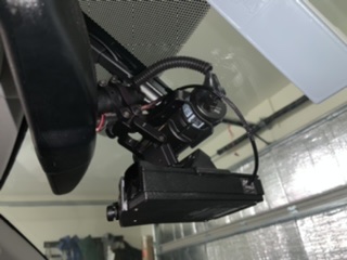

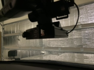

I like the mirror tap, made it a lot easier and cleaner. But understand the accessory part, I use to have the speed off wires in.
The Mirror Tap is pretty easy to install. No running wires into the fuse box. I just moved my V1 over from my other car and it took literally three minutes. Most of that was Googling to confirm the blue wire was the +.
